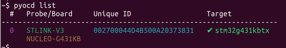

Sometimes an STLink is able to identify the chip it is connected to, and sometimes not. I think it only works for STLinks that are embedded into a dev board, like one of the Nucleo boards.
For instance, I have an NUG431KB Nucleo board. When I plug it into my computer via USB (and thus am using its embedded STLink), I can get the following:
pyocd pack install stm32g4
# Lots of output, errors and warnings are usually fine
pyocd list
# Probe/Board Unique ID Target
# 0 STLINK-V3 002700044D4B500A20373831 ✔︎
# stm32g431kbtx
# NUCLEO-G431KB

2023-06-01 11:43 AM - edited 2023-11-20 5:00 AM
pyocd list
# stm32g431kbtx
# NUCLEO-G431KB

2023-06-01 11:49 PM
Thank you. I see my STlink is not able to recognize connected mcu.
The flashing seems to work!
