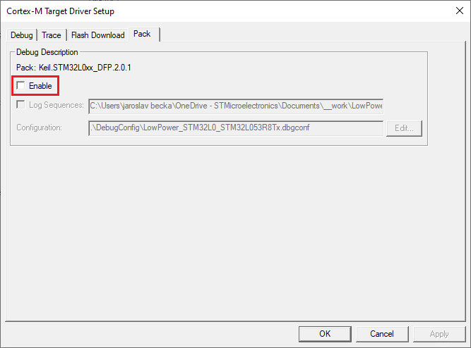

Hello, I use CubeMX 6.1.1 and Keil 5.33.0.0 I got error "Invalid ROM Table" when trying to flash the MCU. with Debug settings set to Under Reset / HW Reset
Thomas LB
By default the ST-Link Debugger setting Pack "Keil.STM32L0xx_DFP.2.1.0" is Enable and I got error "Invalid ROM Table" when trying to flash the MCU. But If I just Disable the checkbox Enable in the Pack tab in ST-link Debugger setting then the flashing is OK :)
I'm I doing something wrong or is this a bug ?
Thanks for help,

A more detailed log from another project when flashing (same conditions):
File    : C:\Keil_v5\ARM\PACK\Keil\STM32L0xx_DFP\2.1.0\Keil.STM32L0xx_DFP.pdsc
Sequence  : DebugPortStop
Context  : Item #2: <control if="DoDebugPortStop">
         Item #0: <block>::Line 3
Expression : "v5\ARM\PACK\Keil\STM32L0xx_DFP\2.1.0\Keil.STM32L0xx_DFP.pdsc"
E310    : Debug access failed - cannot write value 0x00000000 to DP register 0x08
Flash Load finished at 17:30:12

Hi Thomas,
in Options for Target... under Debug -> Settings -> Pack,
make sure to uncheck "Enable".
This solved the problem for me.
Currently, I have no explanation for this behavior, likely a bug in Keil.

Sure, but to me it's ST<->Keil bug so I can help by providing contexte and workaround but I think it is ST job to talk to Keil to fix it. For the record at the time a case was opened (00124133), someone at ST (@Jocelyn RICARD​ ) did reproduce de bug but can't find explanation so the case was "escalated" and closed but never got news from it :\
