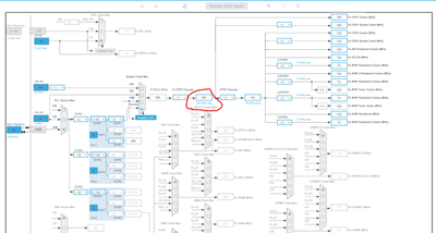

Hi there,
According to the STM32H755 datasheet, the Cortex-M7 frequency can reach up to 480MHz.
However, when I configure the sysclk in STM32CubeMX, it shows the maximum frequency is 300MHz.
What's wrong with my config? Or is there any misunderstanding by me?
Thanks for your help!

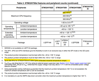

Imen.D
Hello @Junde ,
I think you are selecting STM32H755xxx3!!
Try select STM32H755xxx6 with which you can reach 480MHz.
Thanks
Imen

Hello @Junde ,
Thanks
Imen
