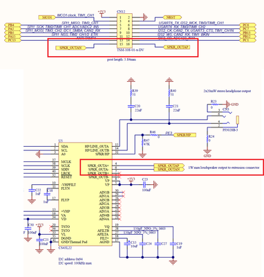

I'm using a STM32F469i- discovery board for developing a prototype & would like to use the Audio DAC feature in it and it is given in the datasheet that one set of pins (15 & 16 in CN12). I checked this discovery board's and also the controller's datasheet but were unable to find any information regarding the resistance of the speaker that can be connected to the pins. Will this pins(15,16 in CN12) be able to comfortably drive a 8 ohm speaker, having watt-rating less than 1 W? Would love to get some insights on this

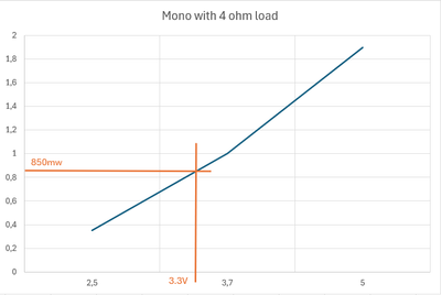

According to the following graph I dressed which is based on the data of the datasheet, you can connect 4 ohm speaker but at 3.3V you cannot exceed ~850mW (by interpolation).
In any case, you need to contact Cirrus Logic for confirmation as its the IC manufacturer: https://www.cirrus.com/support/

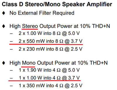

This something related to the codec itself so need to refer to the CS43L22 datasheet.
According to its document:
For more details you can contact the Codec manufacturer "Cirrus Logic".

He's talking about the on board audio codec output:

No. STM32 doesn't have Audio DAC (only regular DAC) but some boards have audio codec on board as STM32f469-Disco board. For this board, it's the CS43L22 from Cirrus Logic. Some of its outputs are mapped on CN12/pins 15 & 16.

Oh so, since this STM32 disco board is already having a Audio codec, I can directly plug in the speakers to the mentioned pins(CN12- pins 15 &16), and from the Datasheet you have shared earlier, I can see that I can connect a 4 ohm speaker having a rating of 1W, one small clarification I have you have underlined those 2 details because the voltage provided on those pins are 3.7V (which gives the Vrms to be roughly 2.5V, right) ?
So, in conclusion if I have understood it rightly, if I connect a 4 ohms speaker, rated with a power of 1W, I can safely drive the speaker using only STM32f469  since it has a audio codec integrated.
