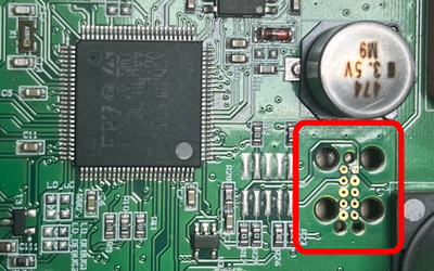

Je me permets de vous contacter afin de solliciter votre aide concernant le débogage d’une carte basée sur un microcontrôleur STM32L471 ( comme présenté dans les images suivantes ).
Je souhaiterais pouvoir programmer et récupérer les logs de la carte, et je cherche donc le matériel nécessaire pour cela (interface de debug, câble, connecteur et éventuellement sonde de programmation type ST-LINK).

Please give some more details of this board: Is it your own design? Is it your own software? Schematics?
@HMTb wrote:
I would like to be able to program ...
The STM32L471 supports both SWD and JTAG for programming/debug - so you'll need to determine which one is implemented on your board.
All ST-Links support both SWD and JTAG, and 3rd-party products are also available, such as J-Link:
https://www.st.com/en/development-tools/hardware-debugger-and-programmer-tools-for-stm32.html
@HMTb wrote:
... and retrieve the board's logs
Logs are entirely down to the software - so only you know what logs there are, and how they are intended to be retrieved.

But it looks like this:

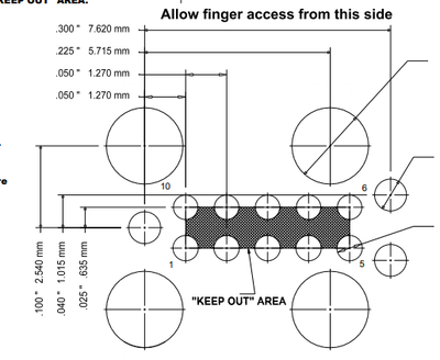

might be a 10-pin TagConnect; eg,
https://www.tag-connect.com/product/tc2050-idc-050-all
https://www.tag-connect.com/wp-content/uploads/bsk-pdf-manager/TC2050-IDC_Datasheet_7.pdf
But you'd still need to verify that; eg, there might be a non-standard pin assignment.
