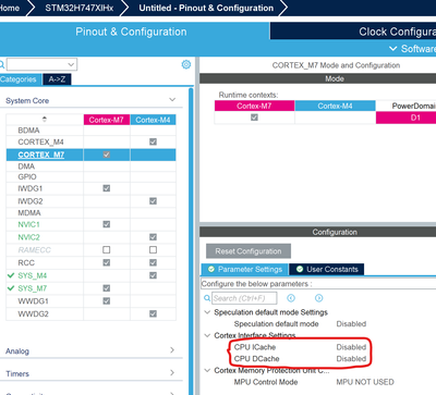

I am wondering how to configure the MPU in CubeMX (6.12.1) so that I can enable the D-Cache and the I-Cache. I know the instructions that enable the caches (SCB_Enable_x_Cache(); replace _x_ with I or D) but was wondering on the configuration CubeMX generates.
I am using the STM32H747I-Discovery board and CubeMX produced:

It sounds like it is disabling access to the memory. I read through the reference manual and looked through the code (core_cm7.h, stm32h7xx_hal_cortex.h) but could not find a clear answer to how I would want the MPU configured.
I would like to have the caches enabled as I want the highest performance from the M7 core.
Thank you for your time and assistance with this question

‎2024-09-30 5:30 PM - edited ‎2024-09-30 5:31 PM
To enable data and instruction cache, enable them in the CORTEX_M7 tab, just above the MPU. No additional MPU configuration is needed as the default will allow them to be cached.
Lots of information in Level 1 cache on STM32F7 Series and STM32H7 Series.
In your code, the "MPU_InitStruct.SubRegionDisable = 0x87;" line prevents the MPU settings you have from affecting the RAM, which is where data is stored. Nicely explained here by @mÆŽALLEm:

‎2024-10-03 1:09 PM
Hi @TDK,
Thank you for the additional information. I had enabled the MPU but did not understand the setting in CubeMX.
I did not make any changes in CubeMX for the MPU (except enable it) when it generated the code. The "MPU_InitStruct.SubRegionDisable = 0x87" was what CubeMX generated, I did not even know what exactly it meant.
The links you provided were helpful.
