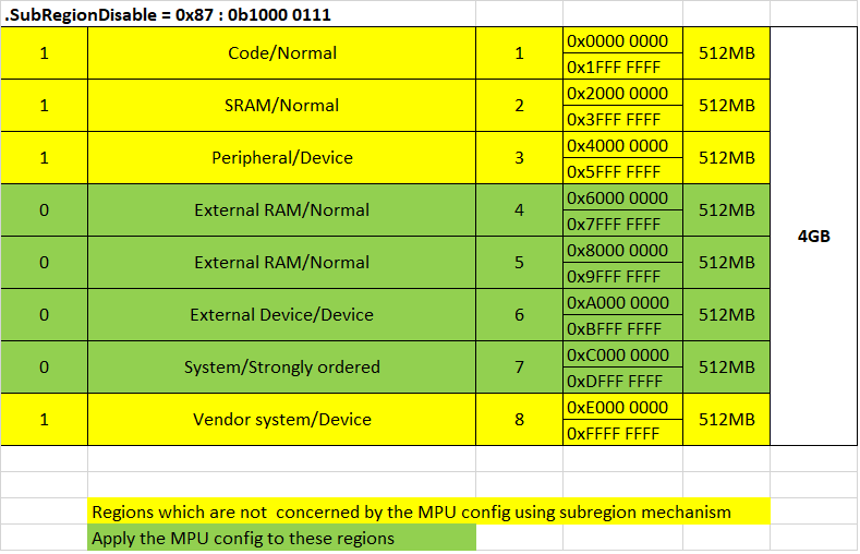

I am working on a project for DMA transfer of data from multiple channels of AD in the STM32H745.
Cannot get A/D data. I am having a problem with it
Since the STM32H745 does not have an ADC DMA project, the STM32H743 project is being ported to the STM32H745
I am checking the MPU settings.
The usage of the MPU_InitStruct.SubRegionDisable setting is not understood
The setting is 0x87, what does this mean?
The project that I refer to
STM32CubeH7\Projects\NUCLEO-H743ZI\Examples\ADC\ADC_DMA_Transfer\Src

0693W00000HpjApQAJ.png.SubRegionDisable means disable current MPU config for subregions set to 1.
In a given MPU region, there are 8 subregions. So if you divide 4GB (in this case) by 8 you will find 512MB. If you look at memory mapping of default MPU of ARM (4G), you can notice, there are 8 address ranges of 512MB.
There are 4 subregions (of 512M) targeted by this default MPU config in the range: 0x6000 0000 to 0xDFFF FFFF which corresponds to external memories range (FMC, QSPI, OSPI etc ..).
In the above MPU config, each subregion has a size of 512M. MPU_InitStruct.SubRegionDisable = 0x87, will prevent regions in yellow to being set by this config. These regions still in their default MPU config.
SubRegionDisable = 0x87 : 0b1000 0111 --> each bit set to 1 means: don't apply the current MPU config to that subregion.
