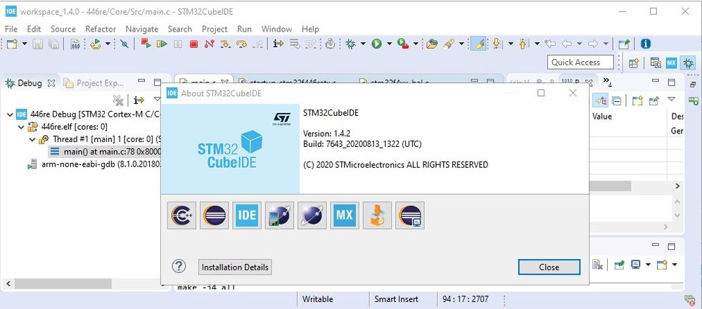

On Windows 10, I just updated (again) to the 1.4.2 version, hoping to solve this issue, yet nothing changed.
Already tried a clean install (again) and re-installed the latest STM32CubeProgrammer: nothing changed.
Will ST handle this sooner or later please? Or at least give some help in diagnosing the problem? Thanks

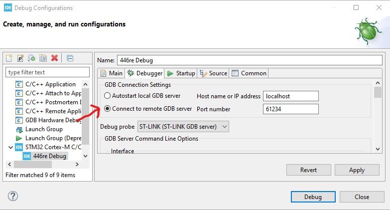

this are my temporary solution
  1. at the moment for make ver 1.4.x debug work, i siwtch debug configguration to remote gdbserver option0693W000002lA4oQAE.jpg

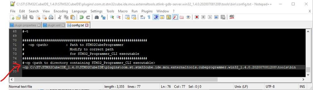

  2. modify config.txt in the folder "C:\ST\STM32CubeIDE_1.4.0\STM32CubeIDE\plugins\com.st.stm32cube.ide.mcu.externaltools.stlink-gdb-server.win32_1.4.0.202007081208\tools\bin" for correct path   for STM32_Programmer_CLI executable0693W000002lA61QAE.jpg

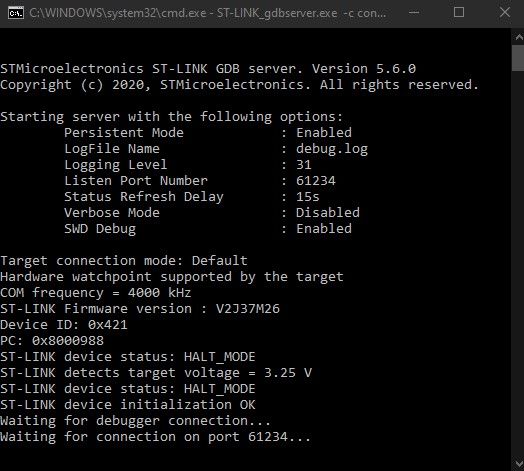

  3. Start ST-LINK_gdbserver.bat manually, it will launch win cmd prompt0693W000002lA6VQAU.jpg

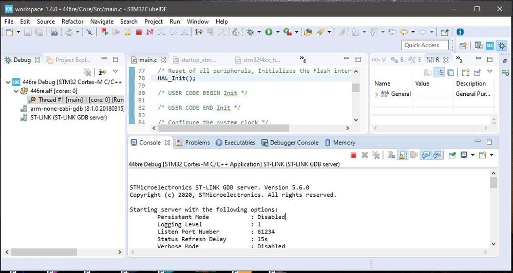

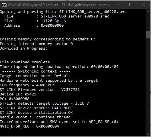

  4. start debugging from stmcubeide and it's work0693W000002lA74QAE.jpg0693W000002lA6kQAE.jpg
