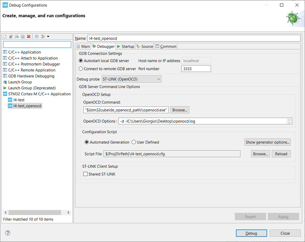

On Windows 10, I just updated (again) to the 1.4.2 version, hoping to solve this issue, yet nothing changed.
Already tried a clean install (again) and re-installed the latest STM32CubeProgrammer: nothing changed.
Will ST handle this sooner or later please? Or at least give some help in diagnosing the problem? Thanks
64 REPLIES 64
I tried setting up an OpenOCD debug confguration, adding -d and -l options to log the output (see attached image): got no debug at all...
I then tried by manually starting stlinkserver.exe first, with the same -d3 option as before, then again launching the OpenOCD debug. Still no debug from the openocd.exe, but got the one from stlinkserver.exe which I am attaching.

OK, openocd also not working as expected.
