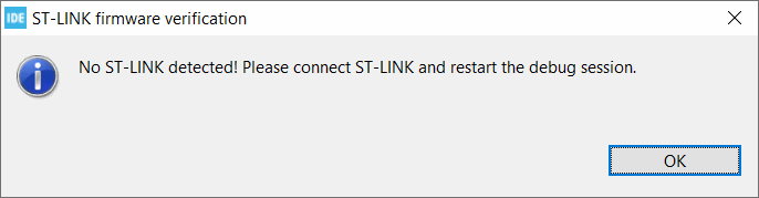

[BUG] ST-Link firmware verification - No ST-LINK detected message since 1.4.x update.
gcrisa
On Windows 10, I just updated (again) to the 1.4.2 version, hoping to solve this issue, yet nothing changed.
Already tried a clean install (again) and re-installed the latest STM32CubeProgrammer: nothing changed.
Will ST handle this sooner or later please? Or at least give some help in diagnosing the problem? Thanks

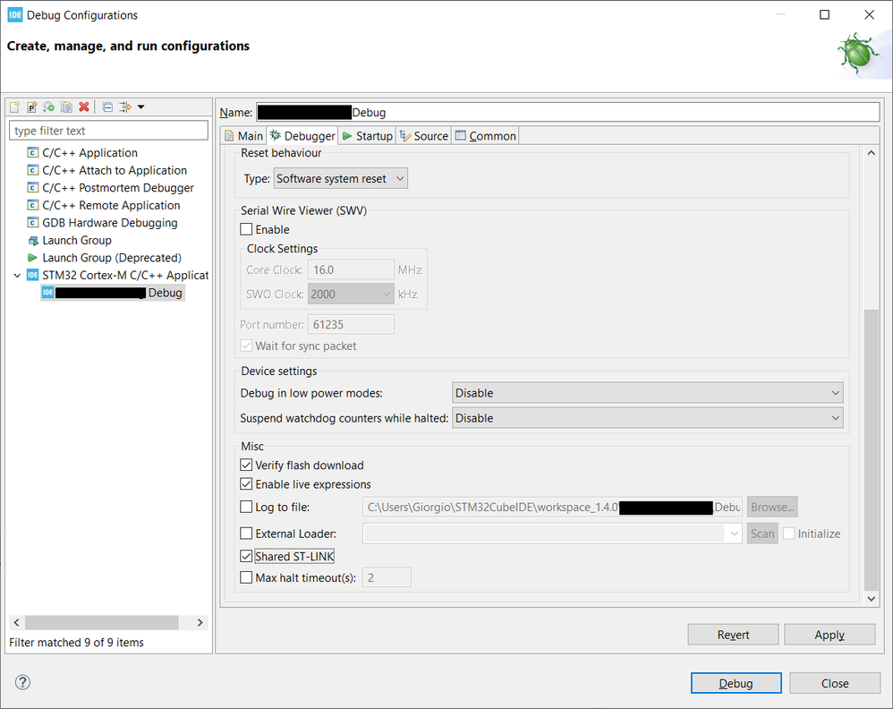

Can you check in debug configuration, with "Shared STLink" option checked that you can see the STLink's Serial Nb.

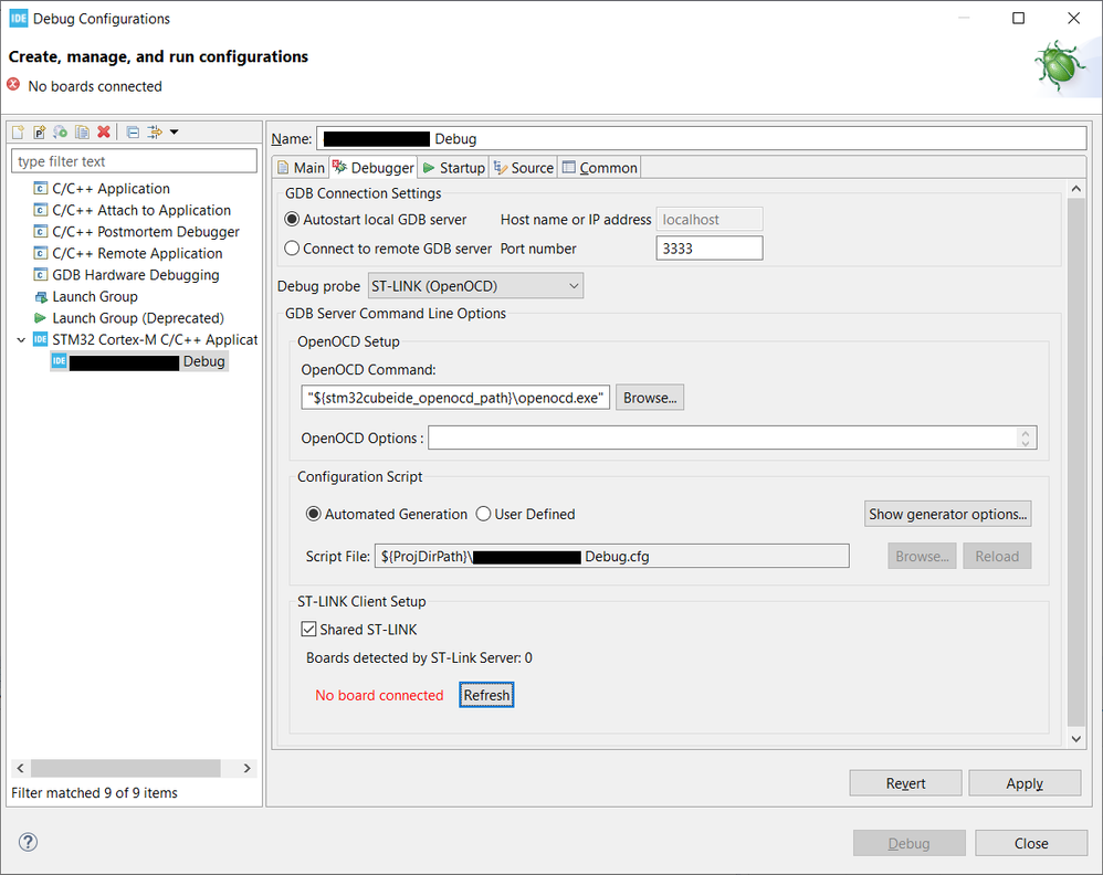

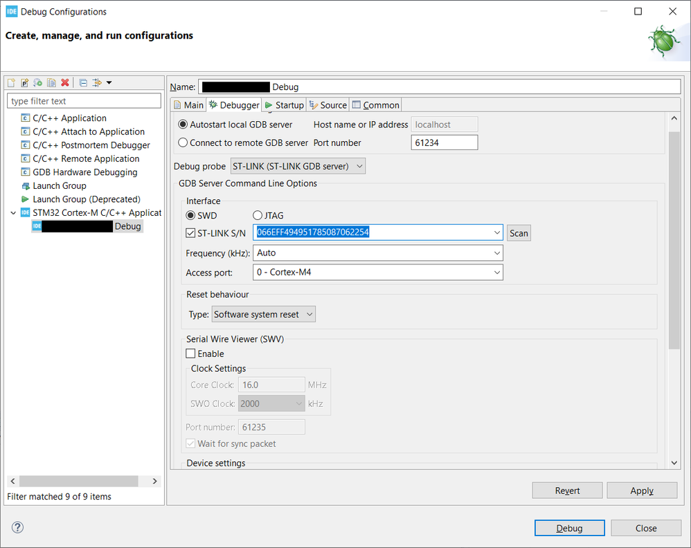

With stlink gdb server, you can click on ST-Link S/N and then scan button and see if the SN text window is populated.
With openocd, you have a window in the bottom displaying all the STLinks connected.
Just checked it now. I tried both ST-LINK GDB and OpenOCD, both times having the "Shared STLink" checked.
ST-LINK GDB: I can see the serial number, but can't start the debug session.
ST-LINK OpenOCD: as I click the scan button, no boards gets detected, and the debug session doesn't start either.
Here some screenshots, hope they helps...
