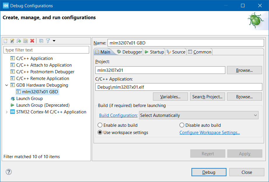

I would like to resurrect this thread - for the case when the STM32CubeIDE will not create the Debug Configuration;
eg, https://community.st.com/s/question/0D53W00000Y2lIsSAJ/cant-usecreate-debug-config-for-oss7-stack
In such cases, it seems that you'd have to set up your own 'GDB Hardware Debugging' configuration - using openOCD, etc
See: https://community.st.com/s/question/0D50X0000AyBp0K/is-it-possible-to-debug-a-makefile-project-into-stm32cubeide
It seems that ST have created their own, modified OpenOCD: https://github.com/STMicroelectronics/OpenOCD - so the question becomes, how to use that "manually" ?

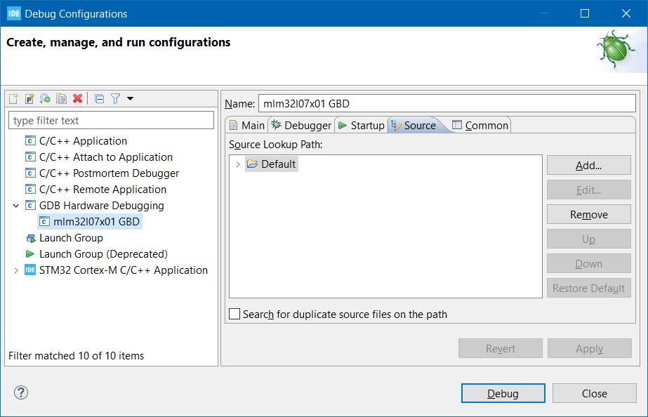

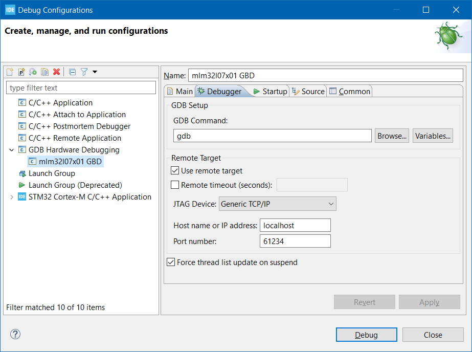

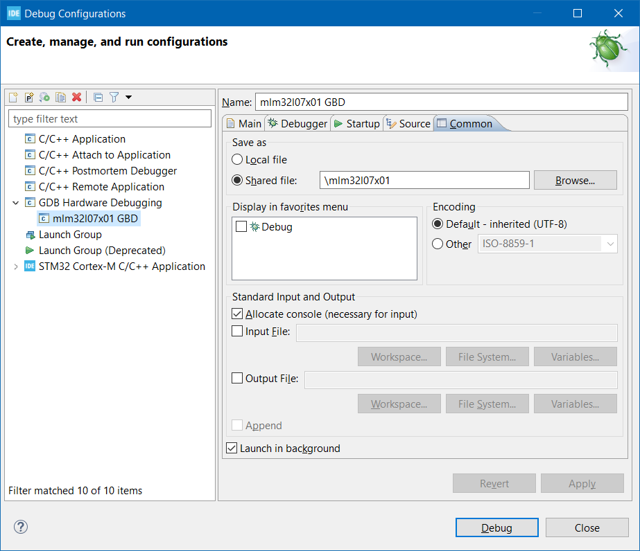

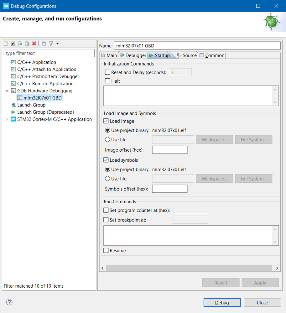

So far, I have defined a 'GDB Hardware Debugging' Configuration:
0693W000007EjfjQAC.png0693W000007EjghQAC.png0693W000007EjhzQAC.png0693W000007EjiTQAS.png0693W000007EjixQAC.pngYou need to manually start the GDB Server before launching the Debug:

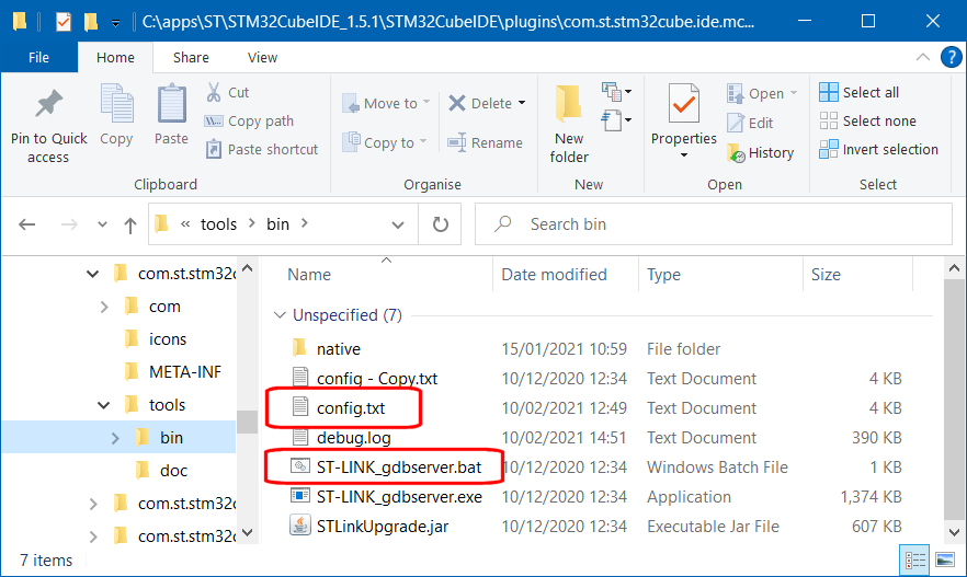

0693W000007Ejm6QAC.pngSTM32CubeIDE_1.5.1\STM32CubeIDE\plugins\com.st.stm32cube.ide.mcu.externaltools.stlink-gdb-server.win32_1.5.0.202011040924\tools\bin
The 'config.txt' needs to be edited to specify the path to the STM32_Programmer_CLI executable - see comments in the file
then run the .bat file

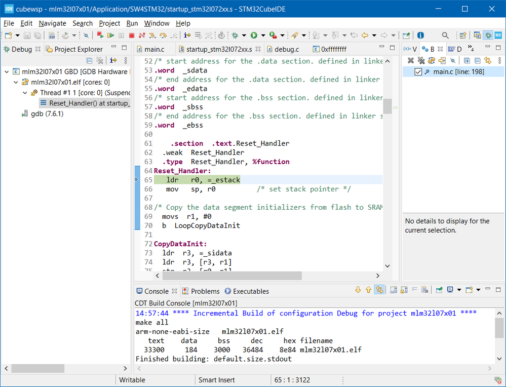

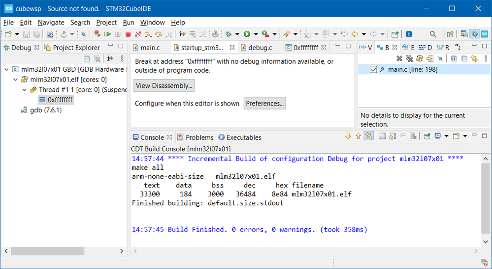

When I start a debug session, I see:
0693W000007EjqNQAS.png'Resume' goes to:
0693W000007EjrLQAS.pngand there it seems to be stuck.
