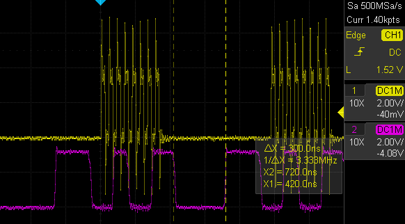

waclawek.jan
> [why txallowed]
Consider this scenario: First write to DR fills the Tx buffer. SPI starts to transmit, the Tx buffer is thus empty, if txallowed is not checked, second write goes to the buffer. Then an interrupt cuts in, lasting longer than it takes to transmit both bytes. The result is, that there is one correctly received byte, and the second - as it finishes receiving before the first one has been read out - overflows and gets lost.
It's an afterthought and it prevents the Tx buffer to be used effectively. Because of the underlying problem (ie. that receiver can't hold 2 bytes at once), the possibility of utilizing the Tx buffer in polled implementation is limited, nevertheless better solutions are possible but would require rethinking how the routine works. Rewriting it in asm would probably help, too. Or, interrupts would need to be disabled, but then there goes universality (and still things like collisions with other busmasters would need to be considered, too).
> That is 134 CPU clocks
> I can't see anything in that code taking more than roughly 1/10 of that
That you can't see it, does not mean it does not exist. Maybe you should look harder.
> and anyway most of it is pipelined behind the UART shifting the bytes in/out.
I don't know what does this mean.
But you should stop using "UART" for the shift register (even USART is not approriate in this case, IMO).
> Looking at the disassembly shows roughly 4-5 assembler instructions for each C line which is nowhere near enough to use up that many CPU clocks.
Show.
For example, this
if ((__HAL_SPI_GET_FLAG(hspi, SPI_FLAG_TXE)) && (hspi->TxXferCount > 0U) && (txallowed == 1U))
is likely to amount to 3 C lines, so maybe a dozen of instructions. And they don't execute in one CPU clock each. For example one of the first of those instructions reads from the SPI status register. That means, that the read request has to traverse the AHB-to-APB bridge and the data traverse the same bridge in the opposite direction. This is likely to last one to three APB cycles plus some AHB cycles, and given this is the "slow" APB at 1/4 of AHB, it means maybe a dozen of system cycles. And still the given flag has to be separated (maybe masked) and a conditional jump has to be performed.
I took your function and got it running on an 'F429 Disco at 180MHz system clock. And inserted the pin toggling (used the green LED on the Disco):
        while ((hspi->TxXferCount > 0U) || (hspi->RxXferCount > 0U))
PIN_SET(GREEN_LED);
          /* Check TXE flag */
            *(__IO uint8_t *)&hspi->Instance->DR = (*hspi->pTxBuffPtr);
            hspi->pTxBuffPtr++;
            hspi->TxXferCount--;
            /* Next Data is a reception (Rx). Tx not allowed */
            txallowed = 0U;
PIN_CLR(GREEN_LED);
          /* Wait until RXNE flag is reset */
          if ((__HAL_SPI_GET_FLAG(hspi, SPI_FLAG_RXNE)) && (hspi->RxXferCount > 0U))
            (*(uint8_t *)hspi->pRxBuffPtr) = hspi->Instance->DR;
            hspi->pRxBuffPtr++;
            hspi->RxXferCount--;
            /* Next Data is a Transmission (Tx). Tx is allowed */
            txallowed = 1U;
0693W00000HrS17QAF.png(Yes, here I have an even worse probe than you). Yellow is SCK, purple is the green LED, timebase is 200ns/div. So we start with a cca 220ns (40 cyc) positive pulse which indicates the write to SPI->DR, then during transmission we see the alternating polling of Tx and Rx flags (even if TXE is set after the first SCK pulse, there's no more write to SPI->DR due to txallowed being zero), cca 100 ns each, maybe 15-20cyc. After the last SCK pulse, RXNE gets set, that's why we see a long negative pulse where SPI->DR gets read (cca 300ns, 55cyc); as that sets txallowed, a long positive pulse for SPI->DR write follows (again cca 220ns/40cyc).
The compiler decided to do the green LED GPIO_BSRR writes from registers, so those are truly single-cycle and don't impact the total timing too much.
Following is disasm of the portion where RXNE is tested and SPI->DR written, that together with the test at the beginning of loop lasts cca 300ns/55cyc, it's around 25 instructions. Given there are two reads from the slow APB bus included (amounting to perhaps two dozens of cycles), I think this is entirely justified (btw. all memory reads/writes go from/to the CCM, so they *are* single-cycle):
