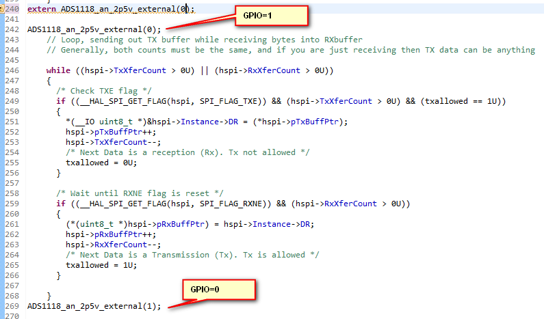

I am using a chopped-down function from the Cube HAL code to talk to a serial FLASH. The original function has a mass of options which were checked at runtime - the usual thing for HAL code...
It's all working fine. SPI2, 21MHz (the fastest I can go with PCLK1=PCLK2=42MHz).
But testing the speed, I am seeing 600us time taken to read 512 bytes. The SPI speed limit should be about 200us. The actual time, obtained by waggling a pin, is 600us. Can anyone see anything obviously wrong with this code? As I say, it works perfectly.

 while ((hspi->TxXferCount > 0U) || (hspi->RxXferCount > 0U))
 /* Check TXE flag */
 if ((__HAL_SPI_GET_FLAG(hspi, SPI_FLAG_TXE)) && (hspi->TxXferCount > 0U) && (txallowed == 1U))
 *(__IO uint8_t *)&hspi->Instance->DR = (*hspi->pTxBuffPtr);
 hspi->pTxBuffPtr++;
 hspi->TxXferCount--;
 /* Next Data is a reception (Rx). Tx not allowed */
 txallowed = 0U;
 /* Wait until RXNE flag is reset */
 if ((__HAL_SPI_GET_FLAG(hspi, SPI_FLAG_RXNE)) && (hspi->RxXferCount > 0U))
 (*(uint8_t *)hspi->pRxBuffPtr) = hspi->Instance->DR;
 hspi->pRxBuffPtr++;
 hspi->RxXferCount--;
 /* Next Data is a Transmission (Tx). Tx is allowed */
 txallowed = 1U;

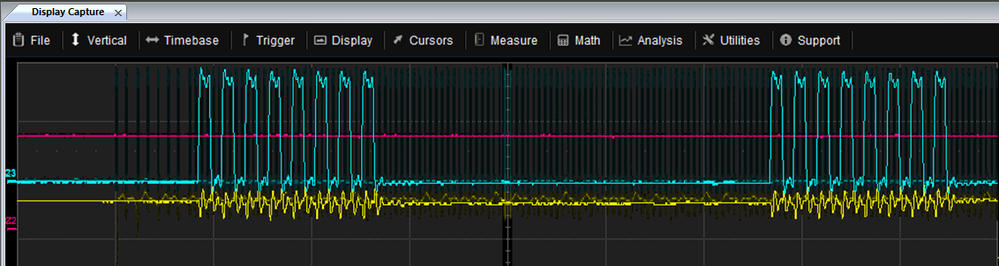

OK here we go. Spot on, the clock bursts have gaps of exactly 2/3 of the time.
The zoomed X axis is 200ns/div.
The waveform is ringing because I am probing the board without decent scope grounds.
Ignore other traces - they are irrelevant. Just the clock.
So what the hell is it waiting for during those 800ns? 2 whole byte periods.
To recap, this is the code
The title of the thread should say 1/3 not 1/2.
January 12, 2022
As we've been saying all along, the code cannot keep up with the data rate. Use DMA, higher optimization settings, or your own code to overcome the issue.
800ns is not a ton of time in terms of cycles. Did you specify your CPU clock rate anywhere in this post?

waclawek.jan
January 12, 2022
> No, there is something in that code which is waiting exactly two byte periods.
Or executing code takes exactly two byte.
Have you read out and checked the SPI registers content? Do you have interrupts enabled on that SPI?

waclawek.jan
January 12, 2022
The mcu does not work out of source code.
Read out and check the relevant registers.
Write a simple test program which does NOTHING but dump 512 bytes through SPI. It does not need to be meaningful for the sFLASH itself, you just observe the bus/timing.
Insert the pin toggling into places within the Tx/Rx routine to see progress there.
