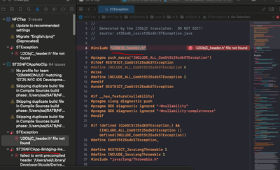

I am trying to compile the IOS NFC tap source code and I am getting open ssl & J2Objc hearder not found errors.
We are trying to read and write with the ST25DV series of tags.
Details
Xcode Version : 15.3
min dev : 15.0
Downloaded source code version : 7.4.0
Does the Source code support the latest versions of IOS?
Any extra steps needed for proper compilation?
Error:
Compilation error
Thanks,
Suresh
Solved! Go to Solution.

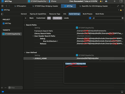

2024-05-26 09:30 AM
Hi Victor,
I again did everything from start.
Followed As per document 9 to 12 pages
1. Download for NFCtap project.
2. Downloaded and installed JRE translated into OBJ-C : • https://github.com/google/j2objc/releases.
did make dist to install
it generated multiple folders into "dist" folder. i.e lib,frameworks,..
3. Link Other -ljre_emul –liconv.
4.Updated paths. Kept path of dist folder which is generated above
5. Setting in J2OBJC_HOME in Xcode and set the value to the J2objC folder
6. Library Search Path: ${J2OBJC_HOME}/lib Setting up
7. J2Objt C code , change J2OBJC_HOME Path to /Users/sai/SATB/j2objc/dist
8. As per 11 page we adding all Files as Import statements in OpenSSL-for-iOS-Bridging-Header.h
5. Open NFCTap project & changed our bundle id , tried to run my iPhone(Xr)
6. Getting error 'J2ObjC_header.h' file not found
7. When we adding all Files as Import statements in ST25NFCApp-Bridging-Header.h then Swift errors coming
Can you help me where i am making mistake?
Thanks,
Suresh

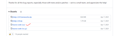

Mean while Can you check below steps.
Can you share any missing steps with screen shots that will be helpfull.
1. Downloaded IOS NFC tap source code(STSW-ST25IOS001)
2.Downloaded Source code from https://github.com/google/j2objc/releases
3. Build using command $make dist . It took some time and created dist folder with lib,frameworks,include
4.Linking JRE also done.
5. Updated search paths with dist folder.

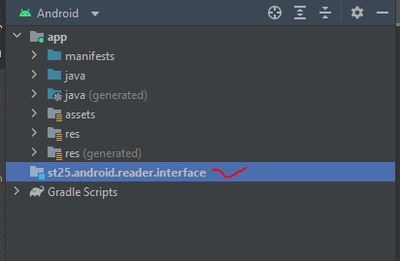

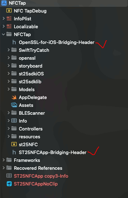

6. There are 2 bridging headers. In which file we need to import header files?
7. Do we need to download any module and link like below?
Thanks,
Suresh

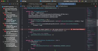

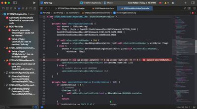

2024-06-01 01:49 AM

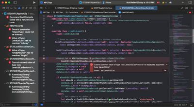

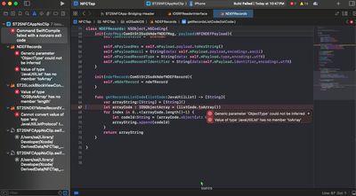

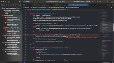

Hi Victor,
Now i am getting below code errors.
Any solution for this?
Thanks,
Suresh
2024-06-02 11:44 PM
Hi Suresh,
At least we're making a little progress...
I guess issues are coming from the latest version of J2OBC used. I delivered iOS NFC Tap with J2OBJC V2.4.
What is your version ?
Thx and br,
2024-06-02 11:56 PM
Hi Victor,
I have used 2.8 release. Let me check with 2.4 version and come back to you.
Thanks for the reply.
