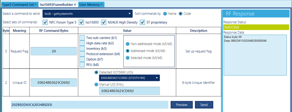

Thank you for your help so far, as per your suggestion I have been trying to build custom commands, in order to do that I am using ST25PC-NFC tool's Frame Builder, as I am only interested for ISO15693 for me it is Iso15693FrameBuilder tab. Again to start simply, to understand how to use iso15693TxRxNBytes() I am just trying to send Get-System-Info of the tag. So I built a frame using the tool and tried the same via tool to make sure I'm not sending any nonsense command, it works fine.
I am sending the same frame via my program, but it is ending up in an ERROR 01, with Error code 02 Command not recognised (format error). Remaining two bytes are CRC16 (X-25).
As I was not getting expected results I started retrospection of what could be wrong, every single time I was ending up doubting on Request_Flag byte, which is common input for any command, I started playing around it, tried to generate possible values via ST215PC-NFC tool, tried to execute it on tool, and then use the same Request Flag value to see if works on my program, but no success so far.

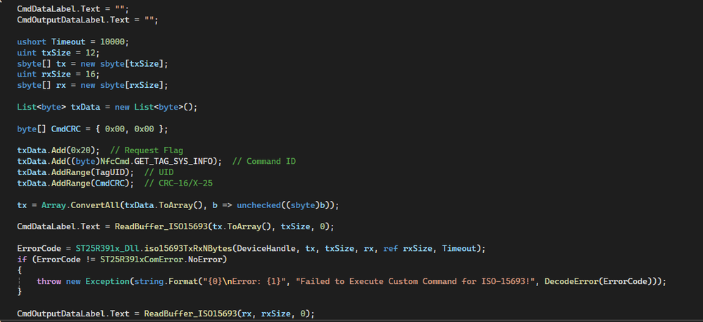

My code to send Get-Sys-Info command:
For, CRC-16, in snippet it shows as ZERO, as I have left it like that, in other case I have calculated CRC16/X-25 and provided as part of command, in both case it has failed with the same Error Code. I have also maximised the timeout.
Could you please guide me, what am I missing here?

Hi JJ,
With the API that you are using you should not use the CRC, it will be automatically generated inside firmware and appended. In your case you would end up with two extra data bytes followed by the real CRC.
AFAIK anyhow the firmware will adapt the Request Flag to fit the physical comm params - One subcarrier + high data rate, so your pre-calculated CRC would even be incorrect.
Only with the Physiscal variant (iso15693PhyTxRxNBytes) you need to supply a pre-calculated CRC.
BR, Ulysses
