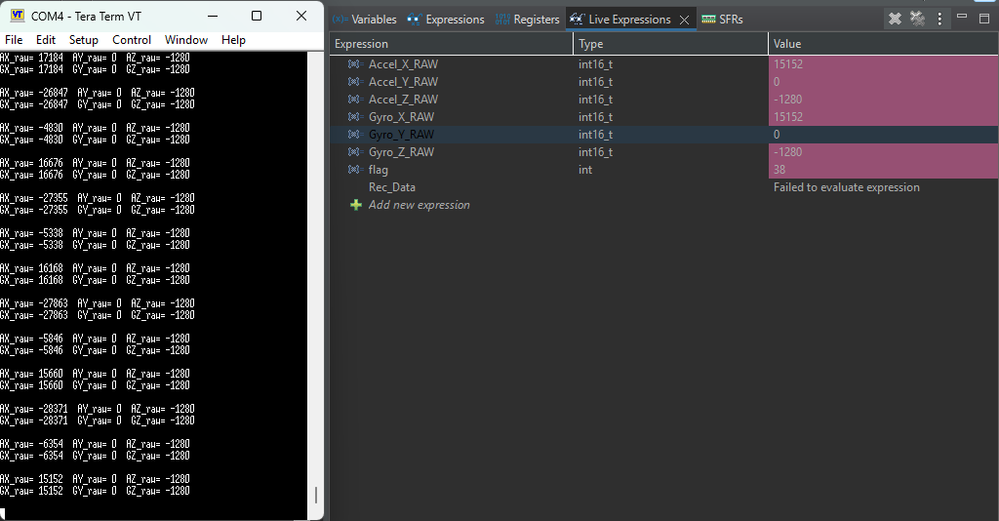

@Andrew Neil
I tried reading the values via UART using Tera Term, but the problem persists.
However, the initial values are now different from before, and the X-axis values swing from negative to positive now. The fact that the values now change by a different amount is related to the additional delay introduced by the UART transmission.
In the code where I didn't use Tera Term when I changed the HAL_Delay(250) to HAL_Delay(500) in the while(1) loop, the X-axis values started changing by a larger increment, and the Z-axis value became -2815 instead of the previous -1280.

I added only snprintf and HAL_UART_Transmit to functions that read the values of the sensor.
So here are the results in Tera Term. Values are the same as Live Expressions show it.
Have you looked at the comms on the I2C wires?
  • Use an oscilloscope to check that they're clean, at the right levels, sensible edges, etc
  • Use an analyser to see the data.
Have you tried just printing the raw bytes from the sensor - before doing any conversion maths on it?

The element I trust the least in this chain is the update rate and consistency of the "live expression" view.
Are you sure about the timing and concurrency properties of the HAL_UART_Transmit implementation ?
I am not. Although I don't use HAL/Cube.
If you want to verify, add GPIO output pulses and use s scope (mixed-signal scope) to observe the timing of your application.
If I want a sequence with reliable timing, I store a realtime sequence of samples in RAM, and transfer them afterwards via UART. If you want to do it in realtime, you need to check your implementation and timing carefully to not interfere with each other.

Today during my internship, I connected an oscilloscope to the sensor and discovered that the ground connection was consistently faulty.
I should have mentioned earlier that all my electrical connections are made on a breadboard because I plan to add some servomechanisms to my small project. I'm not sure why, but despite rebuilding the circuit multiple times and changing cables, the ground was never properly connected between the sensor and the power supply from stm. I plugged the ground pin of sensor directly to stm ground.
Now that the ground is correctly established, everything is working as expected.
Indeed - that's why we so often say that some good, clear photos of your setup can help.
Solderless breadboards are notorious for unreliable connections.
