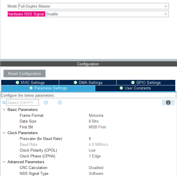

I used SPI for the configuration, here are my configurations for the CubeIDE:
SPI configuration:

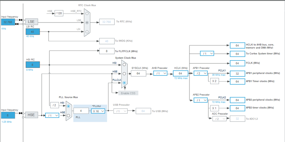

The clock configuration:

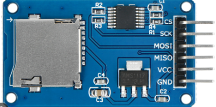

I use this SD card reader module
