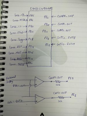

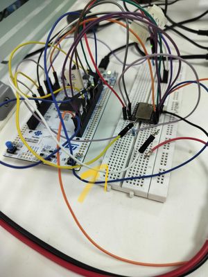

We don’t have an oscilloscope, but we do have a Picoscope. I will check with that and update you. Please find below the setup image, where a white jumper connects from Comparator 1 pin (PB2) to the supply through a 10 kΩ resistor
We are using a window comparator to monitor high and low threshold voltages, with the threshold levels provided to the comparator through the on-chip DAC peripheral. Please find below the schematic, which I have drawn for testing purposes. Since this is only for testing, we do not have any official documented schematic.
Andrew Neil
With masses of long flying wires like that, it's not surprising that you pick up noise!
