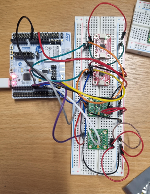

I don't know how long your cabling to the breadboard is.
@NicRoberts This is where the good, clear photos of your setup could help!

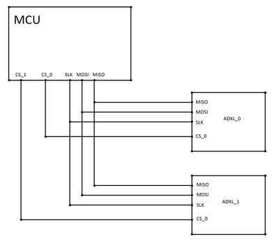

Also still waiting to see your schematic.
And solderless breadboards are notorious for poor connections ...

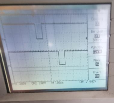

I would start with a logic analyzer, .
I would start with a scope,  to see if there are any "analogue" issues - noise, levels, rise/fall times, etc ...
Schematic
Picture (shows 2 temp sensors on the I2C1 bus, I disconnected them for the SPI tests)
I'll get the scope on it when I get time later today. After your post I suspect that PA9 (my CS_1) isn't acting like a GPIO IO even though the HAL GPIO init indicates that it is,

Your schematic doesn't identify which pins you've used - neither on the Nucleo board, nor the MCU.

@Danish1 Could it be timing? The delay between asserting CS1 or CS0 and starting / stopping the SPI transfer?
I've but in a 1ms delay after each SPI transfer, see trace below, top CS0, bottom CS1.
