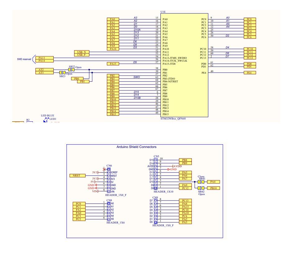

Have you verified that none of the CS pins, especially PA9, is connected to onboard peripherals ?
PA9 does have a number alt functions but I have it configured as a GPIO output. When I scope it its acting as expected, PA9 in the lower trace & is going low & high as expected (see image in last post to Andrew)
The question was whether the Nucleo board has anything connected on PA9 ...
Ahhh right, the user manual says its function is TIM17_CH1. I'm confused here as the scope trace shows it acting as implemented as a GPIO output.
You really need to look at the schematics to see if anything else is connected.
From the schematic I cant see that PA9 is connected to any other peripherals or devices on the board
