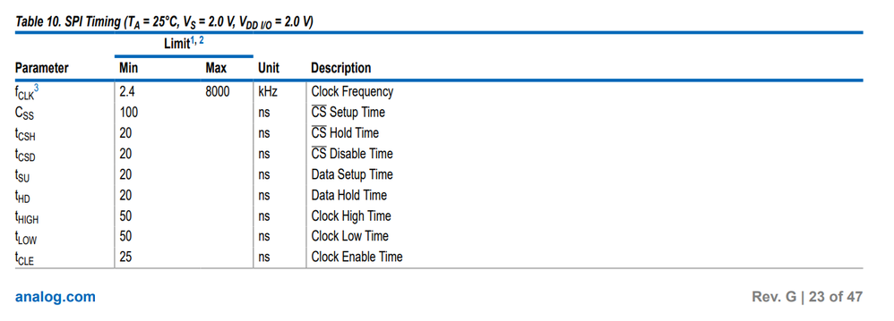

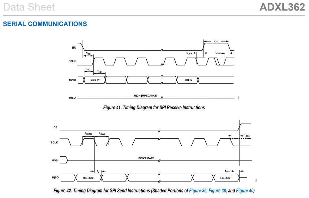

Make sure you are fully  abiding by the timing requirements:
in particular the CS Setup, Hold, and Disable times, and the Clock Enable time:
