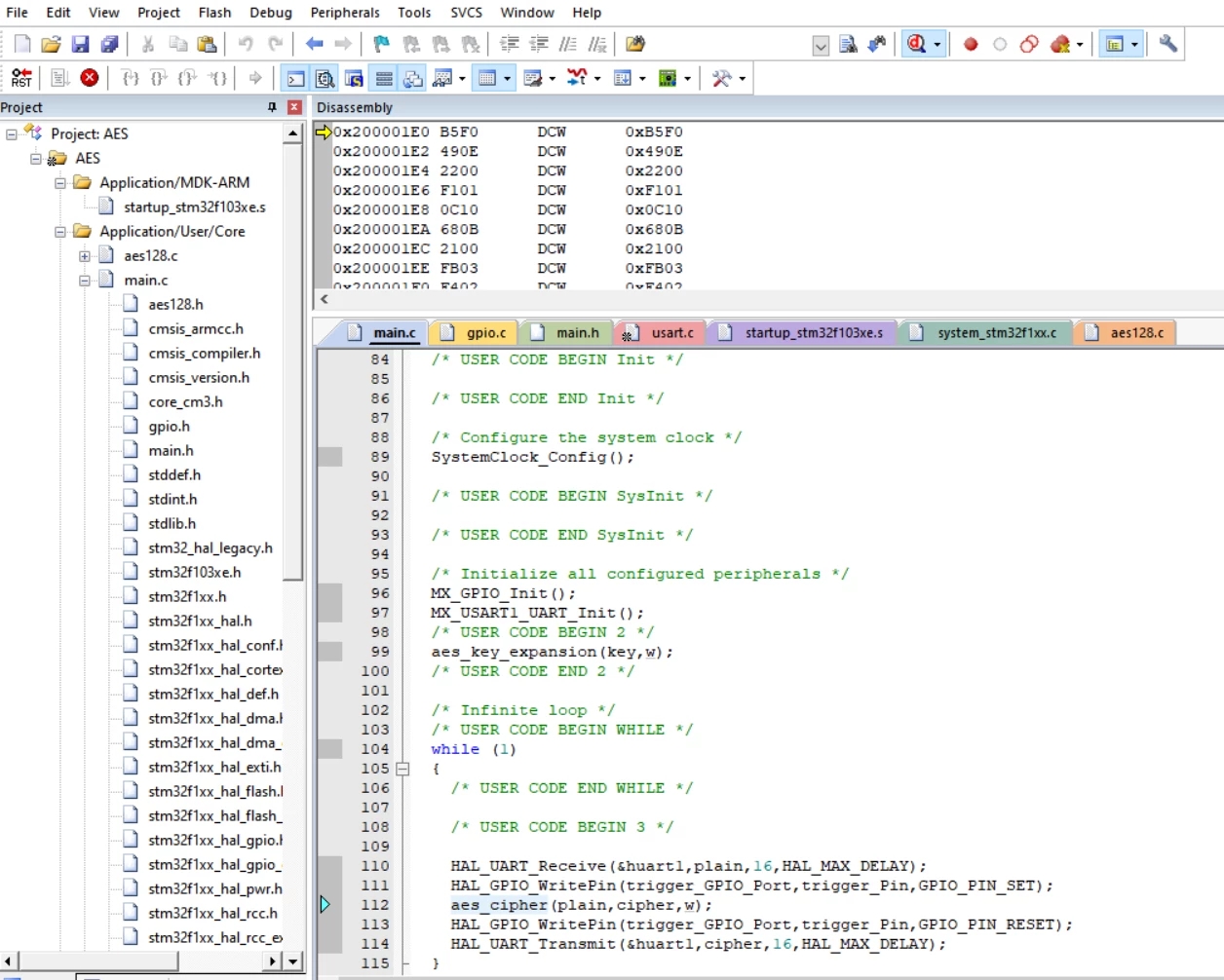

MCU: STM32F103RCT6
Toolchain: Keil MDK v5.31 + DAPLink debugger
Behavior:
Program flashes successfully via DAPLink.
Debug session starts but never enters main() – halts at address 0x200001E0 (check Disassembly/Register window).
All debug buttons (Step, Run) are grayed out except Reset/Stop.
Key Observations:
Same code runs correctly on another STM32F103 board.
Rebuild/Clean did not resolve the issue.
The "Option for target" as below.
So somewhere in the startup code.
Look at the startup code to see what should be happening ?

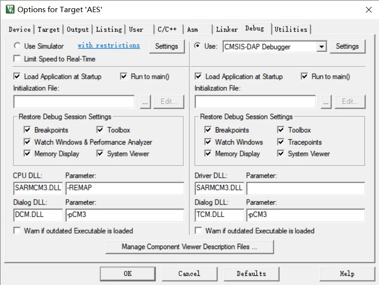

As usual, try to locate the "Run to main" setting in your debugging environment, and disable it.
The code obviously fails in the init code, most probably during clock setup.

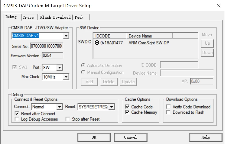

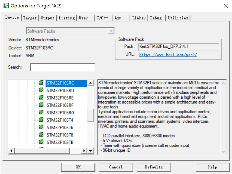

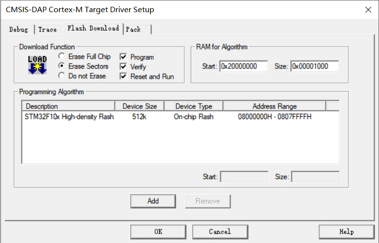

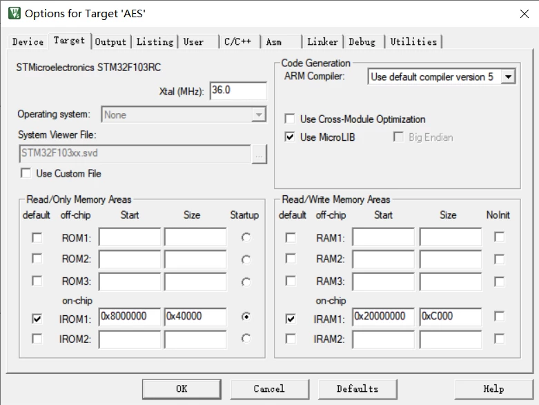

2025-04-02 5:46 AM - last edited on 2025-04-03 1:38 AM by Andrew Neil
This is what I use. Another board are the same as this one.
