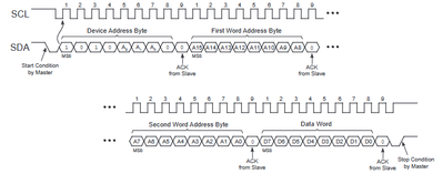

Currently, I am using Keil Microvision 5 for programming STM32. Now, I want the example code of I2C to communicate between EEPROM and STM. I am using the STM32F103C8 controller and AT24C512C EEPROM. I searched about that, but I only found the example codes of STM32CUBEIDE and codes based on the HAL library. So if anyone have that code or example please send me. here I have attached the datasheet of STM controller and EEPROM.

If you are good at I2C calls in SPL, it is easy to implement for i2C EEPROM. You can write to any location by writing first address byte which is composed of page+location. After sending the address, do a i2C restart and send the data. In EEPROM data is always stored as bytes. In your program convert other types to array of bytes, write it into locations. While reading, do the reverse. The datasheet of this EEPROM gives you the logic for the i2c write for bytes, page write examples.
