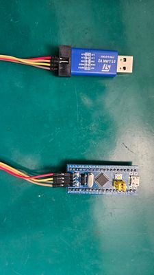

Hi Everyone,
I am facing an issue where my Blue Pill development board (STM32F103C8T6) is not being detected by ST-LINK V2 when using either STM32CubeIDE or STM32CubeProgrammer.
Both tools consistently show the “No STM32 target found” error message. I have two Blue Pill boards and two ST-LINK V2 programmers, and I am facing the same issue on both setups, which makes me believe it’s not a wiring or hardware fault on a single unit.
My Hardware Setup:
  • Boards tested: 2 × Blue Pill (STM32F103C8T6)
  • Programmers tested: 2 × ST-LINK V2 (Firmware version: V2J34S7)
  • Target voltage: ~3.1V (as detected by STM32CubeProgrammer)
  • Connections:
    • 3.3V → VCC
    • GND → GND
    • SWDIO → SWDIO
    • SWCLK → SWCLK
Steps Tried:
  1. Verified all SWD wiring and signal continuity using a multimeter.
  2. Tested both “Hardware reset” and “Software reset” modes in STM32CubeProgrammer.
  3. Updated ST-LINK firmware to the latest version (V2J34S7).
  4. Switched between multiple USB ports and cables.
  5. Verified target power (3.3V stable).
  6. Ensured BOOT0 = 0 (Normal boot from Flash).
  7. Tried connecting with and without NRST line connected.
  8. Reinstalled all ST drivers and software tools.
Despite all these attempts, the target MCU is not detected in either CubeIDE or CubeProgrammer on both ST-LINKs and both Blue Pill boards.
I have tried the above steps then also I cannot resolve this issue, can anyone please help me to resolve this issue.

I think that this is may be due to the fact that some blue pill may are based on a clone MCU and not an original one. Also, some of the ST-LINK V2 are also clone products (more details here). So, those products may not connect to the ST Tools.

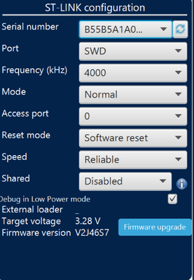

@Bharath_5
How old is your firmware ? V2J34 ...mine is not up to date, but shows V2J46 !
So update CubeProgrammer, then update st-link and try again connecting.

First, I notice the voltage is a bit low 3.09V. Is the power connected to some heavy load? Or is there anything that is short circuited on your target circuit. Second, if you are using the cloned STLink/V2, the voltage shown is the voltage of the STLink, not the voltage detected on the target MCU.
So, you need to probe the 3.3V pin of the target MCU to see if the voltage is correct. Third, if you use this type of STLink/V2 (cloned or original):
then you have to supply a separate power to your target board because it does not provide 3.3V power through its TVCC pin.
Hi @AScha.3
Thank you for your response. I really appreciate your time and support.
My firmware version is V2J46S7.
I have downloaded the latest version of both CubeProgrammer (V2.20.0) and STMCubeIDE (V1.19.0).
I have updated my Firmware again, but I am facing the same issue

I am using the below STM32F103C8T6(Blue Pill) and ST-Link V2.
Hello @Issamos,
Is the Blue Pill and ST-Link I am using not original?

Every BluePIll is perfectly original. The problem is not so many BluePills contain STM32 microcontrollers. Most of them use Chinese clones.
Your debug module is a Chinese clone of ST-Link, which violates ST licences.
During last 4 years ST put some effort toward not supporting the illegal ST-Link clones and non-ST microcontrollers in their software and they have full rights to do this.
Technically it's still possible to use the hardware you have for development but since it's ST-owned forum, describing how to compromise their intellectual rights protection does not seem to be proper.
There is usually nothing wrong with BluePills, it's just you are not entitled to use ST software and illegally cloned debug hardware for development.
For non-commercial stuff you may use any non-STM32 BluePill with Keil MDK-ARM and CMSIS-DAP debug interface.
