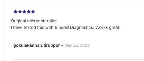

@AScha.3 wrote:
from the links -> board comment:
> This is a clone, so it wont work with debug mode in stm32CubeIDE. Otherwise working fine
> priyammascharak2002 – January 5, 2024
Also:
But then:
Which is the trouble with these no-name boards - it's a matter of luck what you actually get!
