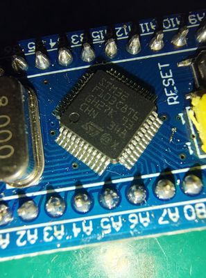

Question is: are the chips still alive and are they genuine STM F103 ?
So if possible , show good pic of the cpus on blue pill boards.
link, where you ordered them (just to see, what they write)

Close-up photo of the STM32F103C9T6 Micro-controller you said for and below is the purchase link from where I have purchased the Blue pill and ST-Link V2.

from the links -> board comment:
> This is a clone, so it wont work with debug mode in stm32CubeIDE. Otherwise working fine
> priyammascharak2002 – January 5, 2024
So we can assume: big chance, to have a cpu not by STM on the board.
But anyway , we should get a connection in CubeProgrammer, even if it might show "wrong" chip ID .
(Only debug mode  in IDE then not possible.)
