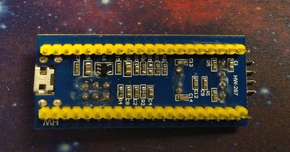

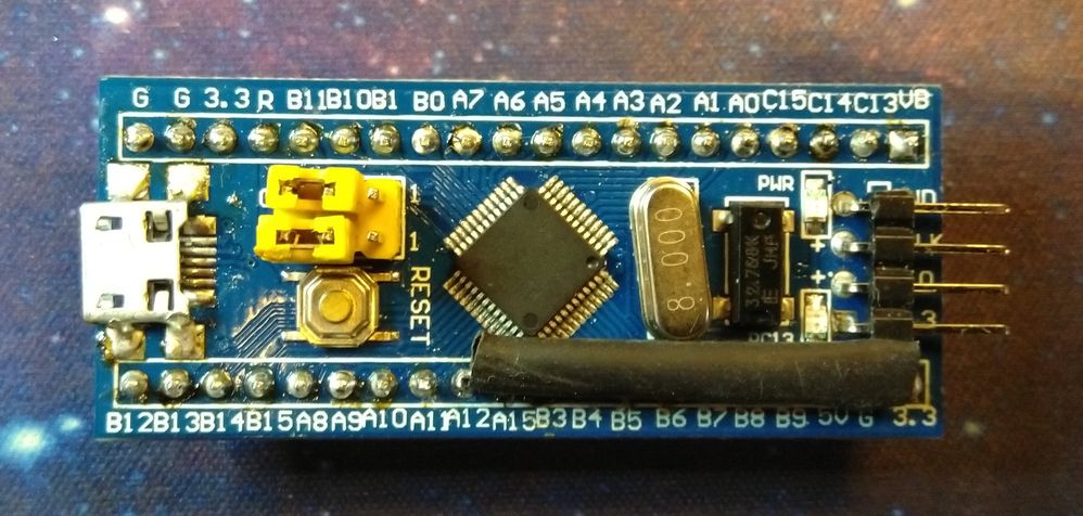

show us a picture of your board, is there a chance is an aliexpress bluepill?
JChaj.1
0693W00000YAc84QAD.jpg0693W00000YAcAAQA1.jpgI don't buy from AliExpress, but that doesn't mean its not a clone. I puchased it maybe a couple of years ago from eBay. Its been sat in a box of bits ever since. The black heat-shrink covers a resistor I added as per instructions to reduce the resistance down from 10k to 1.5k.

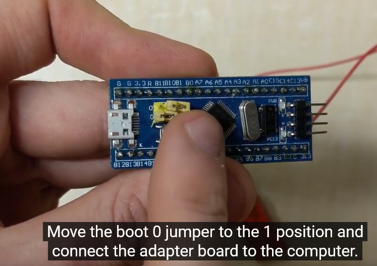

Just checking, did you move the corresponding jumper when flashing the arduino bootloader in your board?
https://www.youtube.com/watch?v=Myon8H111PQ
AScha.3
Principal III
the 10k was wrong on all these boards, so 10-> 1k5 is right. is only needed for USB device working mode.
+ the unknown F301 mutating to well known F103 . 🙂
so now we know, what we talking about.
you have to know: you have 3 ways to start / load new program ->
  • F103 fix built in bootloader , by pressing "boot" when power up (or releasing reset) _ DFU mode, but on F103c8 only on USART1 .
  • with STlink connected via debug functions, working always with -> use programmer -> ***
  • you load (with Stlink..) a bootloader program, maybe your "maple xx" or other, and then connect with USB -> cdc "serial" port -> to arduino or other
so first : choose, what you wanna do. (i use stlink always, just working...and arduino only on AVR boards)

I just reviewed that video and I see there is a different URL for the library. I still had the library by Dan Brown installed. I have now updated the library. I have also tried the bootloader discussed in the video, but don't even get a /dev/ttyACM0 port with hid_generic_pc13.bin...
BTW, yes I am moving the jumper to the position shown before flashing.
