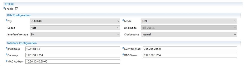

I have SPC58EC-DISP,
now I use sample code(Network Gateway Test),it's MII mode and working;
then,I want to use RMII mode,I set PHY MODE = RMII,it's not working,
how to do it?
ps:The OSC is changed to 50MHz,and SB5 Close & SB6 Open.

Finally, I just correct my IP / mac address and the ping works.
So, for SPC58NG-DISP , to run in RMII, I do 3 modifications :
1) I add the Oscillator chip 50 MHz on the board
2) Change MSCR configuration CRS to CRS_DV
According DP8348 datasheet §6.4.2
The following pins are used in RMII mode:
• TX_EN
• TXD[1:0]
• RX_ER (optionnal for MAC)
• CRS_DV
• RXD[1:0]
• X1 (RMII Reference clock is 50 MHz)
In SPC58xG, the pin configuration is :
0693W000008xEtUQAU.pngOn board.h file ( add 512 on SIUL MSCR)
#define MSCR_MUX_PIN_CRS_0          414U => #define MSCR_MUX_PIN_CRS_0          413U
3) On MDIO , the pin are not correctly configure (in MII or RMII), this pin is bi directional pin
On file board.c, the configuration is
 {(int16_t)MSCR_IO_PIN_MDIO_0, (iomode_t) PAL_SPC5_SSS(13) | PAL_SPC5_OERC(0) | PAL_SPC5_ODC(2) | PAL_SPC5_SMC | PAL_SPC5_ILS(0) | PAL_SPC5_IBE), PAL_LOW},
So the MDIO is configure in Push pull and that not correct.
Change the configuration to Open Drive => PAL_SPC5_ODC(1)

SLEE.6
Great,I can works too,
for the network gateway, 1 modification must be add:
1) add the Oscillator 50 MHz pin to TX_CLK.
