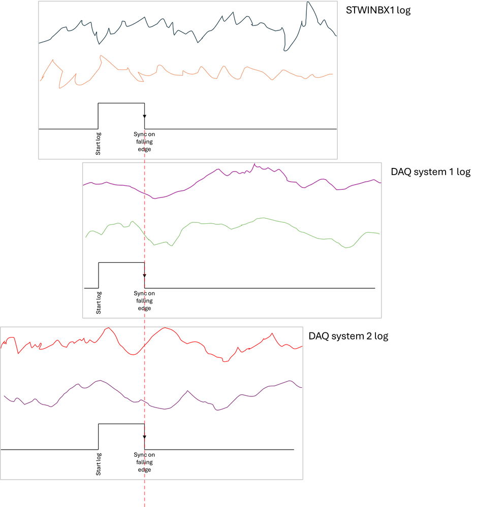

I need to synchronize the data logs from different DAQ systems including the STEVAL-STWINBX1
I was thinking if the STEVAL-STWINBX1 could log a GPS PPS (Pulse Per Second) digital signal, then I could manually (offline) sync its log with the logs from the other DAQ systems.
Or is there some other technique I can use to synchronize all these logs from different DAQ systems (e.g. IRIG, NTP, EtherCAT, PTP).

What would the latency be when using a digital input to trigger a software tag ?
In order to manually sync the STWINBX1 log with the other DAQ systems, there must be very little latency.
There will be a common sync signal between the STWINBX1 and other different DAQ systems...
The logs from each system will be manually synchronised using the common sync signal (e.g. using the falling edge)...
If there is a high (or variable) latency using a digital input to trigger the software tag, then it will not be possible to accurately sync the logs.

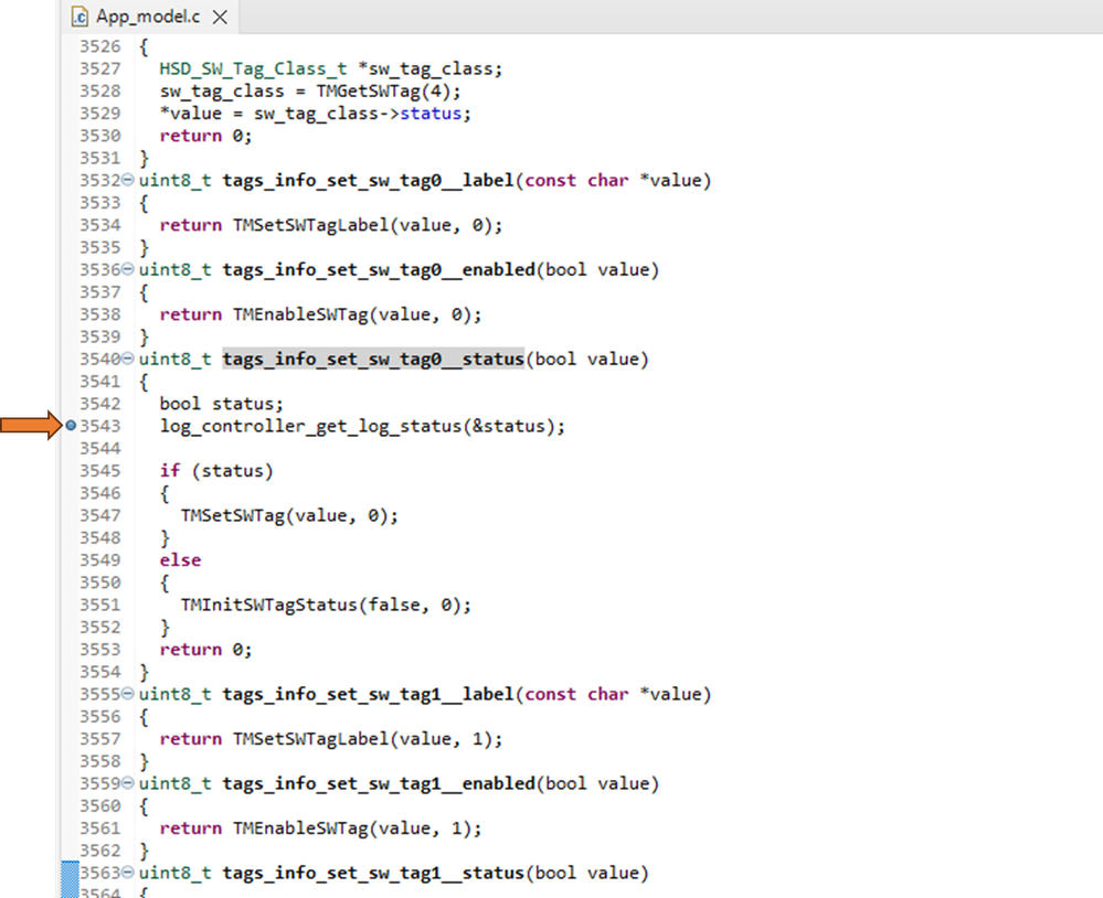

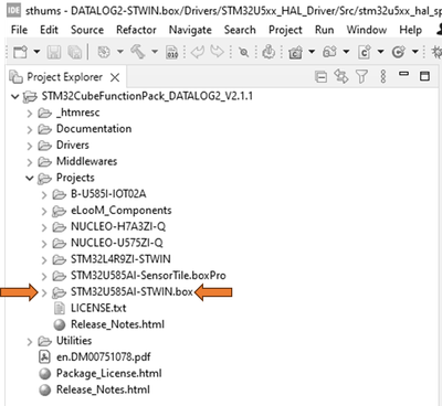

I assume the project for this board is "STM32L4R9ZI-STWIN" ?

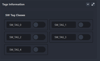

For some reason I can't seem to step through the code and I don't think breakpoints are working (I am using a Segger J-Link base).
I set a breakpoint in the function 'tags_info_set_sw_tag0__status'....
I expected the software to stop here when I toggled the SW_TAG_0, but it didn't...
I don't know whether its an issue with the debugger (as I cant seem to step through or breakpoint the code), I also don't know if I am looking at the right place in the code for the tags ?
Hello @johngj
First, let me confirm you that the project to be used is STM32U585AI-STWIN.box.
You placed the breakpoint in the right point, but it is expected to be toggled only while the acquisition is running. Have you already started the log when you'd look at the breakpoint?
Do you have the same issue by placing a breakpoint in other functions? For example, you can place it in SysLoadApplicationContext in App.c file: this function is invoked at the boot of the firmware, so it should be toggled just after the firmware startup.
Best regards
Simone

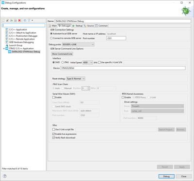

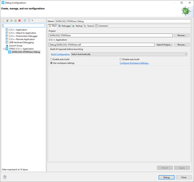

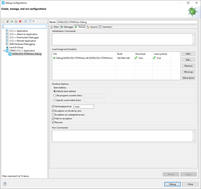

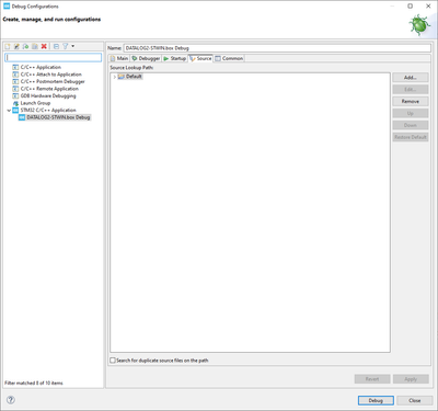

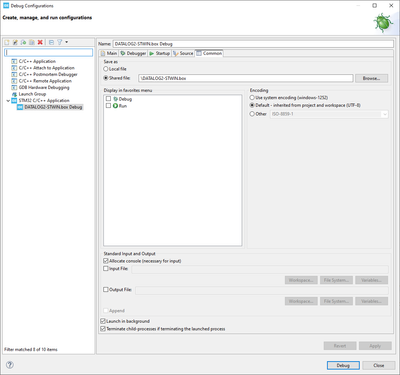

Yes I ran the Python GUI, started the log and toggled all of the software tags, but it did not stop at the breakpoint.
I tried placing a breakpoint in SysLoadApplicationContext in App.c file, but it did not stop at the breakpoint.
Usually when I debug, by default it stops at a breakpoint in main once downloaded, but this does not happen when I debug FP-SNS-DATALOG2.
The console also show some errors - see below...

Writing register 'pc' = 0x0806A5CC
ERROR: Programming failed (error code = 1) for block @ address 0x08000000 (90436056)
Read 4 bytes @ address 0x0806A5CC (Data = 0xFFFFFFFF)
Read 2 bytes @ address 0x0806A5CC (Data = 0xFFFF)

Could the issue be something to do with the fact there are 2 flash banks for the firmware ?
Hello @johngj ,
please be sure that you are flashing the firmware on the first flash bank.
Detailed instructions are available in the FP-SNS-DATALOG2 User Manual, chapter How to handle double bank flash memory.
I can't provide you support for Segger J-Link product: instead, I strongly suggest you to use an ST-LINK product.
Best regards
Simone
