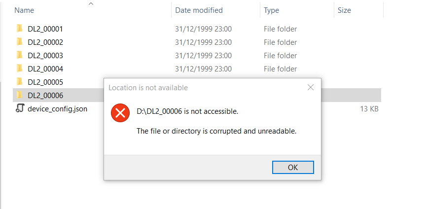

Why does the datalogger crash when I put a device_config.json file on the SD card ?
I created the device_config.json file using the Python GUI tool, saved it to the computer and then copied it to the root folder of the SD card.
The only changes I made was to the accelerometers where I changed the range to 4g (with the exception of IIS2ICLX which was left at 3g).
I put the SD card in the STWINBX1 and pressed the RESET button.
When I try to start the log (by pressing the USER button) the software seems to crash.
The green LED (LED_1) stays in the state when the USER button was pressed (i.e. permanently on or off).
The board has to be reset, but then the same happens again if I try to start a log.
When I try to access the log files on the SD card on the computer, I get an error saying the directory is corrupt, so this probably shows that the software is crashing...
I cannot delete the folders, so I have to reformat the SD card.
I have attached a copy of the device_config.json file (note I had to rename the extension to .txt in order to attach).

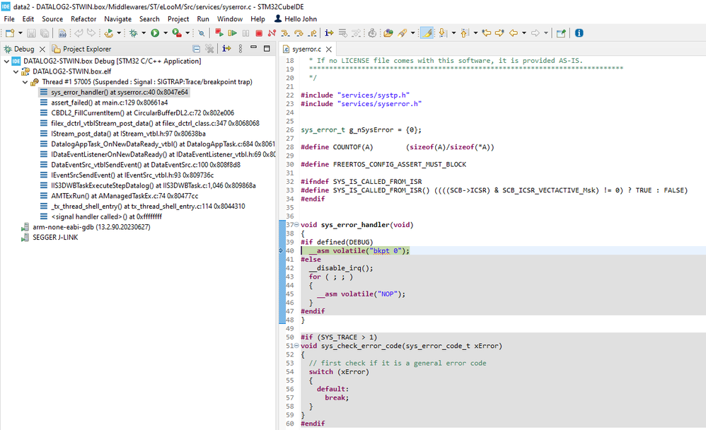

2024-08-02 6:47 AM
I have updated to v2.2.0 and the issue still exists
In this instance it went to a system handler....

2024-08-06 8:28 AM
Yes I used the latest Python GUI and saved the config file to SD card
If I use the Python GUI to start/stop the log, it doesnt crash
If I use USR button or phone app to start/stop the log, it crashes
