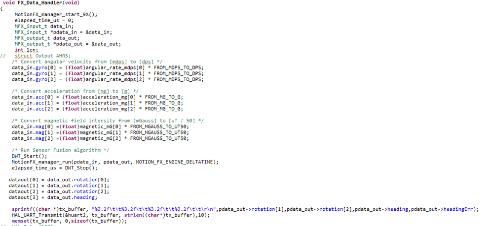

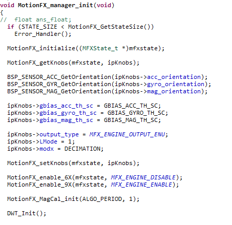

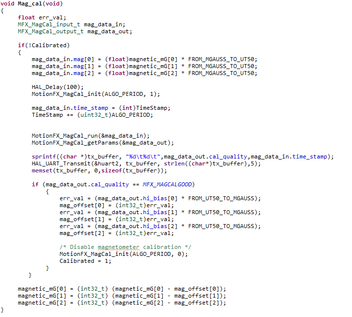

I am using STM32F401CBU6 controller along with 2 sensors ie., (ISM330DLC & ISM303DAC) in my project. I have included motionfx library and getting Roll, Pitch, Yaw and Heading, but the heading is not getting calibrated and values are also changing continuously. i am using datalog fusion latest updated example code from X-cube mems1 with reference to UM2220.
I have tried to to rotate the sensor in all the possible directions to get it calibrate but it is not at all getting calibrated.
Here is the data that i have logged, find the attached.
@Petr S or anyone please have a look and help me out!!!!

Hello Anil,
You've shared only the timestamp and results in your datalog. I need all input data to compare the results and to be able to analyze whether the issue is in input data or in library usage.
Thanks,
Petr
‎2024-08-05 2:22 AM
First please verify you have set correct device orientation in the code.
