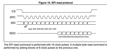

The protocol for SPI transmission is
But my Register always equal to 0. ret = HAL_OK.
I don't understand why :)
Can you help me

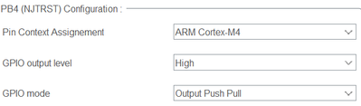

2024-06-28 3:36 AM
my CS:
2024-06-28 3:39 AM
@fru999 - again:
Have you used a logic analyser or oscilloscope to see if what's actually happening in your hardware matches the protocol spec diagrams you posted ?
Among other things, you haven't told us what board(s) you're using - please see:

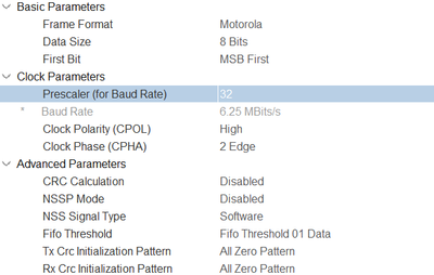

2024-06-28 3:57 AM - edited 2024-06-28 3:57 AM
But "like" is not "it is" .
Imagine : the receiving chip expects a sequence, as given in diagram.
But you send another, in two parts...could work, or not.
So set it to 16bit SPI data size.
2024-06-28 4:07 AM
Ahh, + set : Motorola, with NSS = hardware , to get matching /CS signal. (Then no need to set it in software.)
2024-06-28 4:27 AM
But everywhere I see, bit for the adress and it says 8 bits because each communication is 8 bit long (8bit for the adress, 8 bit for the data but the slave expects 8 bits for the adress and 8 bits for the data and it is separated). If i put 16 bit long the slave will wait for 16 bit for the adress and 16 bits for the data no ?
2024-06-28 4:28 AM
If i do that that means i will not have to toggle the pin every time ?
2024-06-28 4:37 AM
Where you "see 8bits" ?
in your pic:
I see 16bit sequence here.
Right. SPI hardware doing it then.

Read underneath the picture, it is 8 bits the data size
But now the problem is that when I am in reading mode, after transmit receive, the receive data are equal to the transmit data...
Do you have an idea why?
2024-07-18 7:01 AM
Did you set it to 16bit frame at last ?
2024-07-18 8:05 AM
No, I have changed it and i always have hal_error and i have worked with another accelerometer wich description of SPI was the same and the data size was 8
