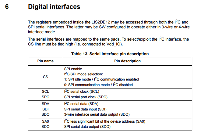

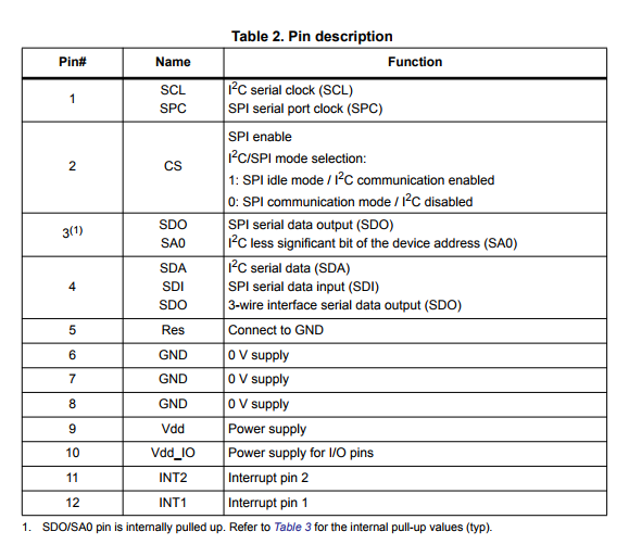

Pin 2(CS) and 3(SDO/SA0) how to connect this two pin with micro controller in i2c configuration.

According to the
http://www.st.com/content/ccc/resource/technical/document/datasheet/group0/72/cb/80/a7/5e/fe/46/9d/DM00153214/files/DM00153214.pdf/jcr:content/translations/en.DM00153214.pdf
, if you want to use I2C, then CS (pin 2) needs to be connected to logic high (Vdd).0690X00000609JVQAY.png0690X00000609JaQAI.png
SA0 (pin 3) determines the I2C slave address of the device (important mainly if you plan to use more devices with possibly conflicting address). Anyway, connect it to logic 0 (GND) / logic 1 (Vdd).
