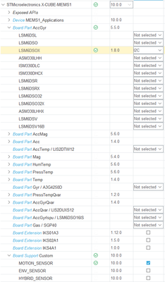

I selected every sensor each board has on the x-cube-mems1 (package) and build it using CubeIDE (no error or warnings), but the Unicleo-GUI shows only the X-NUCLEO sensors, being unable to switch between (for example) the different Gyr/Acc sensors.

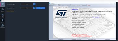

If i dont select the board extension IKS02A1 CubeIDE gives no trouble (0 error and warnings) but the Unicleo-GUI doesnt recognice my board and i get stuck here:
(note: If i select to list all coms it appears, but shows nothing and cannot start)

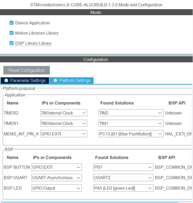

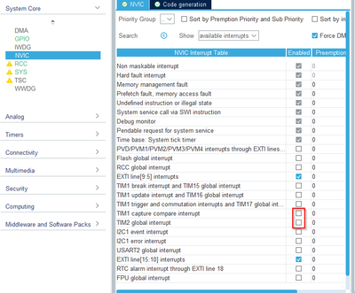

First problem was that your timers should be switched, TIMER2 have to support Capture Compare functionality and you have the timer with this functionality (TIM1) in TIMER1 (I understand that it was logical choice to use TIM1 as TIMER1 but...).
Second problem was that you need to implement the BSP_SENSOR_XXX_GetOrientation functions in custom_mems_control_ex.c file. Here is the example of implementation for LSM6DSO which is onboard on IKS01A3:

What i'm trying to make is a custom board consisting on a nucleo board (dont mind if its L401RE or R476RG), a X-NUCLEO-IKS (dont mind if its 02A1 or 01A3) and a STEVAL-MKI197V1.
I'm trying to work with AlgoBuilder and get the data mostly from the STEVAL sensors. The example workflow below will be using nucleo L476RG, x-nucleo-iks01A3 and the steval:
- I enabled the defaults for this board and activate the PB8 and PB9 for I2C1
- I set Tim1 and Tim 2 with internal clock and default parameters and PB7 as an EXTI
- I activate clock source and calendar from the RTC

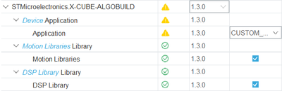

- For the algobuilder Software pack i selected this (the warning goes off later on when i select the MEMS custom motion sensor):
- For the MEMS Software pack i selected this (to make everything easier for starters i selected only the Steval sensor):
The algobuilder pack configuration is as shown below:

If i run the code using the CubeIDE and try to connect the board i get this error (im tying now with MEMS Studio too):
(I know there are no sensor data, but it should at least display the sensor available, am i wrong?)

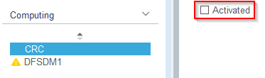

I didn't test it but what I see for the first look is that:
Please try it and let me know.
2024-05-13 05:03 AM
Hi, thanks for pointing out those mistakes, unfortunately it still doesn't work

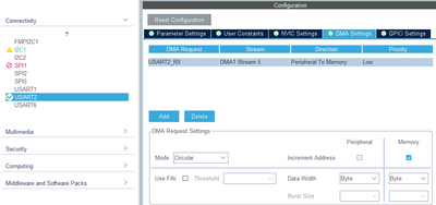

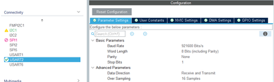

I also enabled usart nvic

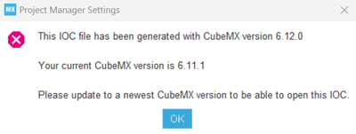

What versions of STM32CubeMX and STM32CubeIDE do you use? Please try latest CubeMX v6.11.1 and CubeIDE v1.15.1. I have slightly modified the ioc file in terms of GPIO pullups, project and code generator settings. It compiles well on my side, I just didn't test it in MEMS Studio on HW.
2024-05-16 02:39 AM
Im using the latest versions released, but the .ioc you provided me doesn't open, it gives an error about being made on CubeMX version 6.12.0
