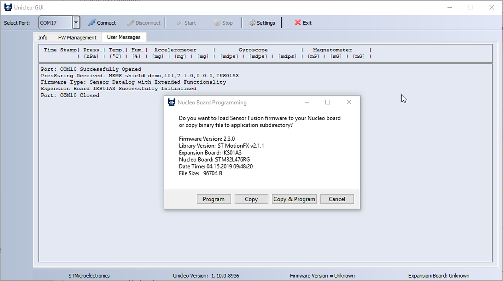

In the \Firmware\Projects\STM32L476RG-Nucleo\Applications\IKS01A3\ you can find project for each library. You can find already compiled binary file in Binary directory. This binary can copied to drive associated with your Nucleo board in File Explorer and it will program the Nucleo board.
Or you can drag and drop the binary file to Unicleo application and it will offer you several options what to do.
I draged and droped the binary file of iks0a3 from mems1 into L476RG board but i don't find anything in fw management
Miroslav BATEK
Drag and drop the binary file to Unicleo application.
How to get this message what should I do exactly
I need the angle as a function of time with unicleo gui
