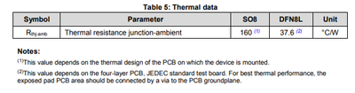

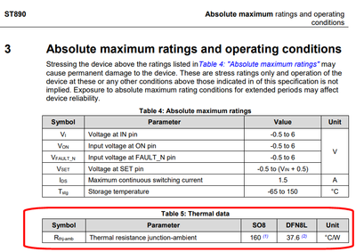

What's this, then:

@rohitgaikwad2702 wrote:
Datasheet specify junction-ambient thermal resistance, but we need the
value of junction-case
Surely, that's the same thing?
You have to read the datasheets yourself and calculate thermal resistance, depending on copper area you put there.
And from ds you see some typical value:
No! junction-ambient thermal resistance and junction-case thermal resistance is two different things.
Did you ?
