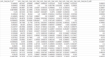

‎2023-08-06 1:58 AM - edited ‎2023-08-06 5:50 AM
Thanks. I have read about these documents and got some sample data. Still, I have noticed that in the .csv document, CNH histogram data is like this:
I have known the principle of aggregate from documents above. Yet I found no information about the unit of these data. So what is the unit of these data?
