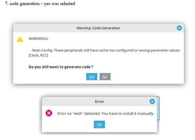

Also, I get this warning:

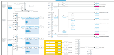

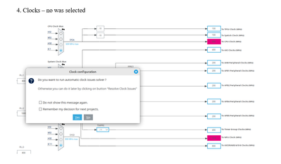

With the downloaded ioc file, I see some clock config errors as:
Is this okay?

I went ahead and generated code anyway, even though there were some warning about wrong configurations
I also keep getting these from the AI window

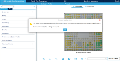

the first error just tells that the cube_FW_n6_v1.1.1 was not found. It is just that the path in my ioc and your pc are not compatible. By default, MX should find the correct path. You can edit it here:
I suggest using the version 1.1.1 as it was tested.

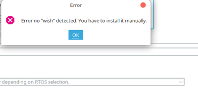

This seems to be an error due to linux:
please install tk using the following command:
sudo apt-get install tk
https://community.st.com/t5/edge-ai/error-no-quot-wish-quot-detected-with-x-cube-ai/td-p/291734
For this, it seems that MX on windows and Linux does not display the same thing.
The clock here is correcly configured.
You can try to ignore this an continue (let me know if it worked please)
I tested to click "resolve Clock issues" after configuring the clock as explained in the tutorial and the final code worked (it is probably slower as the MCU and NPU frequency were set lower in my case).
This RIF issue can be ignored. Depending on the MX/IDE version, and the cube_FW_N6 version, the behavior change, sometime it is checked, sometime no... I don't really know.
For this, if the clock is an issue, try to click resolve clock issue as I said previously.

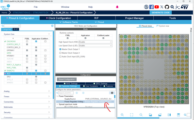

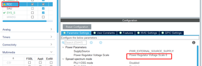

For the RCC issue, the Power Regulator Voltage can be set back to 1 automatically by MX. Change it back to 0
And finally, the wish error should have been fixed with the install of tk.

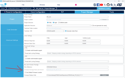

1) The project name cannot be changed - there is a cursor but does not allow changing the name
2) The firmware version reverts back to v1.2.0 automatically on Ctrl + S to save. I tried changing the Firmware Package Name and Version but this does not allow any change as well.

As long as you select the Firmaware package and click generate, I think this should do. Even if you cannot save.

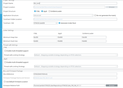

I tried editing the ioc directly:
Generated code and tried building the FSBL and application. Get this error:
../X-CUBE-AI/App/app_x-cube-ai.c:59:10: fatal error: .h: No such file or directory
59 | #include ".h"
compilation terminated.
make: *** [X-CUBE-AI/App/subdir.mk:28: X-CUBE-AI/App/app_x-cube-ai.o] Error 1
make: *** Waiting for unfinished jobs....
"make -j4 all" terminated with exit code 2. Build might be incomplete.
Will now try using reverting the manual ioc edit and just use the v1.2.0 firmware

I can confirm that in STM32CubeMX 6.15.0 on Windows OS, at some point the clock configuration is considered invalid, and the tool insists on lowering the clocks — CPU from 800 MHz to 600 MHz, and NPU from 1000 MHz to 800 MHz.
What is the reason for this behavior? It is very very undesirable in real applications.
ERROR
Senior
Hi all,
STM32CubeMX somehow disables the overdrive mode. The manual recovery is required.
