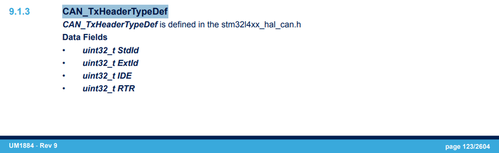

I just using STM32CubeIDE for 2 or 3 days. I am doing a test with a Nucleo-L476RG and CAN bus. With you help, your sample, I make my board talking with other board of mine.
Just a question, maybe a *** one, where can I gather informations about CAN_TxHeaderTypeDefuint32_t RTR  or uint32_t IDE... and so mutch other symbols? Is there a documentation about?
Best Regards,
Maurice.
Andrew Neil
The documentation will be in the User Manual for the Software Pack; eg, STM32CubeL4:
https://www.st.com/en/embedded-software/stm32cubel4.html#documentation
https://www.st.com/resource/en/user_manual/um1884-description-of-stm32l4l4-hal-and-lowlayer-drivers-stmicroelectronics.pdf#page=123
It is also present in the source code - use your IDE's 'Go To Definition' feature to find it

Well, I found the answer... all what I want is defined in stm32l4xx_hal_can.h file...
