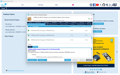

The following software and versions were used:

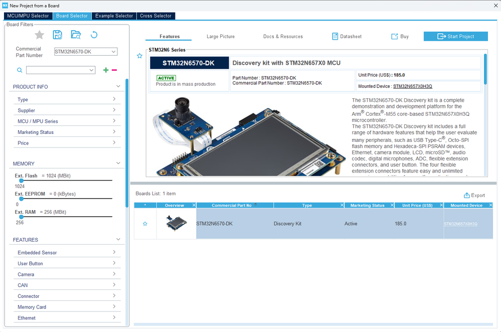

Begin your project by clicking Access to board selector and selecting STM32N6570-DK, which corresponds to the STM32N6 Discovery kit board.
When asked to "Initialize all peripherals with their default Mode", click [No].
While some peripherals may be enabled by default, remove any that are unnecessary to avoid pin conflicts.
Select "Secure domain only" and click [OK]:

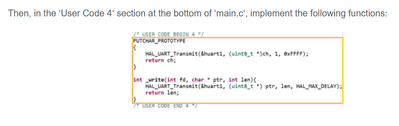

4.2 Add code in Appli
Next, go to the Appli project. At the top of ‘main.c‘, in the private define section, declare the following macro for the ‘put_char‘ function.
#define PUTCHAR_PROTOTYPE int __io_putchar(int ch)
Then, in the ‘User Code 4‘ section at the bottom of ‘main.c‘, implement the following functions:
PUTCHAR_PROTOTYPE
HAL_UART_Transmit(&huart1, (uint8_t *)ch, 1, 0xFFFF);
return ch;
int _write(int fd, char * ptr, int len){
HAL_UART_Transmit(&huart1, (uint8_t *) ptr, len, HAL_MAX_DELAY);
return len;

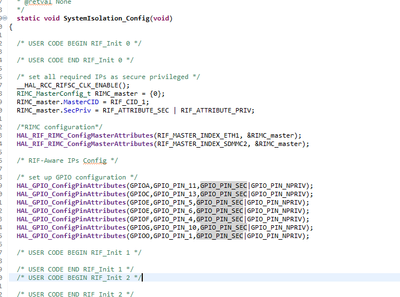

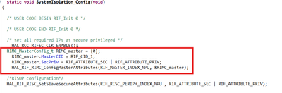

Important note: Depending on the version of CubeMX, X-CUBE-AI, and the STM32N6Cube package, you may have different things in this MX_X_CubeAI_Init() function. Edit it if needed to have exactly what is in the image above.

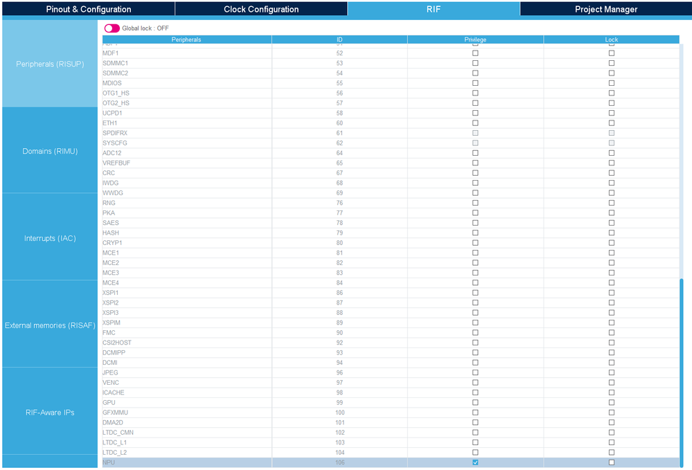

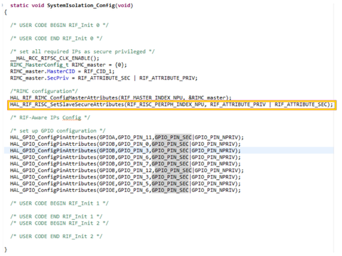

Add the following line to the RIF (SystemIsolation_Config) function to complete the slave configuration:
HAL_RIF_RISC_SetSlaveSecureAttributes(RIF_RISC_PERIPH_INDEX_NPU, RIF_ATTRIBUTE_PRIV | RIF_ATTRIBUTE_SEC);
Important note 2: Make sure that the part of the code above the line we add is present in the generated code. If not, it may indicate an issue in the RIF configuration. Make sure to look back at the Security configuration in CubeMX and that the NPU is selected in the RIF tab of CubeMX.

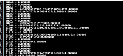

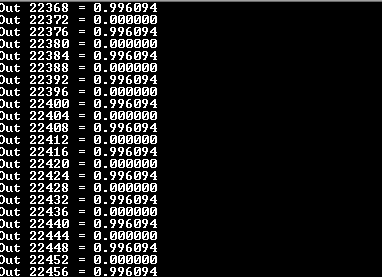

  • Cleaning and invalidating the MCU DCACHE and invalidating the NPU cache prior to inference.
  • Converting integer table values to float and printing them via UART.
The last functionality is implemented because memory is always allocated as an int table, but for this model, the output format is float. An int is 8 bits, and a float is 32 bits. Therefore, reading a single element from the array does not yield 19 valid values. Instead, four consecutive 8-bit values must be concatenated and interpreted as a single 32-bit float. You can copy the ‘MX_X_CUBE_AI_Process‘ function from the script below. After pasting it, press [Ctrl+I] to autoindent the code properly.

		// Invalidate CPU cache if needed
		// Convert int8 to float. Buffer is int8, but model's output is float.
		uint8_t aux[4];
		float_t *conver;
		for(uint32_t i = 0; i < buff_out_len; i += 4){
			aux[0] = buffer_out[i];
			aux[1] = buffer_out[i+1];
			aux[2] = buffer_out[i+2];
			aux[3] = buffer_out[i+3];
			conver = (float_t *)aux;

You will most likely have to enable to use float with printf. In properties:
This model has a 3-dimensional output buffer. To validate the output, only the first dimension is used in this example. Configure a serial terminal, such as Tera Term, with the settings shown in the image below. You are able to observe all the output buffer values.
You can use the Python script provided in the annex (provided at the end of this article). This is used to compare whether the quantized and optimized model running on your MCU produces the same outputs as the original model running on your PC.
To ensure that the application was correctly copied, that the peripheral initialization succeeded, and that the main loop is not stuck during inference, add the following two lines of code to blink LED2:

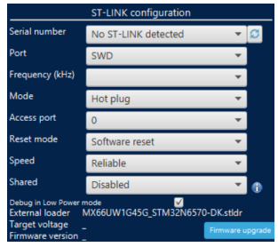

Open STM32CubeProgrammer and ensure that your ST-LINK configuration matches the image below and confirm that the firmware is up to date.

Hello! Julian
Thank you very much for writing this document. Especially in the analysis of the model output section, it was very clear and intuitive, which greatly benefited me. I used the 'yolov8' model and converted it into TFlite. Deployed to STM32N647 using X-CUBE-AI.
Here is my code, and the parsed values are as follows:
Is my interpretation correct like this?

Oct 1, 2025 8:06 AM UTC
Hi @The-Big-Monster,
I think you are printing correctly.
In your case you have the output and the quantization scale and offset, so you can get your float32 output with the formula: f=(q−z)×s, which you did.
Your output is of shape (1,7,1008). YOLOv8 outputs are arranged as:
  • 7 = number of channels per prediction:
    • [class_id, x_center, y_center, width, height, confidence, …] or
    • [x_center, y_center, width, height, confidence, class_logits…] depending on export.
In your example:
<class_id> <center_x> <center_y> <width> <height> <confidence>
So, each of the 1008 predictions is one bounding box candidate.
To compare the output to your label, you need to do some filtering (post processing).
You don’t use all predictions. Typical steps:
  • Dequantize each output value. (which you did)
  • Apply confidence threshold: keep only boxes with confidence > e.g. 0.25.
  • Decode bounding boxes (scale x_center, y_center, w, h back to image coordinates).
  • Non-Maximum Suppression (NMS): remove overlapping boxes, keep the highest confidence ones.
  • Get final predictions to compare against your ground-truth labels.

Oct 8, 2025 11:56 AM UTC
Thanks for this wonderful article on deploying model on STM32N6
When i ran the code above, i had 2 observations. As per the document when i enabled RIF i see only below code generated.
static void SystemIsolation_Config(void)
/* USER CODE BEGIN RIF_Init 0 */
/* USER CODE END RIF_Init 0 */
/* set all required IPs as secure privileged */
__HAL_RCC_RIFSC_CLK_ENABLE();
/* RIF-Aware IPs Config */
2.) When i run with the above code, my module is stuck forever at
LL_ATON_RT_Init_Network(&NN_Instance_Default); // Initialize passed network instance object
do {
/* Execute first/next step */
ll_aton_rt_ret = LL_ATON_RT_RunEpochBlock(&NN_Instance_Default);
/* Wait for next event */
if (ll_aton_rt_ret == LL_ATON_RT_WFE) {
LL_ATON_OSAL_WFE();
} while (ll_aton_rt_ret != LL_ATON_RT_DONE);
Appreciate to know of feedback.

Oct 15, 2025 9:19 AM UTC
Hi @ponara28, I faced the same two issues during my tests. Did you succeed to go through?
Hi @Julian E., thank you for the tutorial. I followed all the steps and even try with the given .ioc file but didn't manage to make it works. I have no log and LEDs doesn't seem to be activated. I change the LED activation in the FSBL to make it happens earlier but doesn't seem to do anything. Where are the two LEDs on the board. Are they LED3 and 4? In that case, can it have conflicts between the LED control we perform from the code and the LED status of the serial connection?
In the guide, you indicated to use the following firmware:
I'm already using STM32Cube MCU package for STM32N6 series: Version 1.2.0 (don't know how to change it), verified on "Help > Manage embedded software packages".
Where can I verify (and also change if needed) that the ST32Cube FW_N6 patch I'm using is Version 1.1.1. Is it included/related to STM32Cube MCU package for STM32N6 series version?
Appreciate to have a feedback.
Thanks
Julian E.
Julian E.Author
Oct 29, 2025 1:53 PM UTC
Hello @Léo,
ST32Cube FW_N6 and STM32Cube MCU package for STM32N6 series are the same things, sorry for this mistake, I will edit the guide.
Please use the version 1.1.1
Have a good day,
Julian

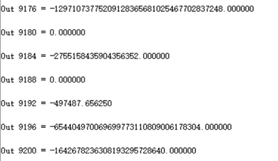

Nov 8, 2025 1:54 PM UTC
Hello! Julian.
@Julian E.
I followed your steps, but why is the content of the SystemIsolation_Config() function in the main.c file of my Appli project different from what you described in your tutorial?
My code was successfully compiled at the end, but after programming and running it, there was no display in the terminal. I'm not sure if there is a problem here.
The following software and versions were used in my project:
