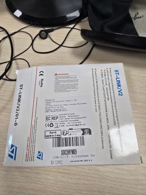

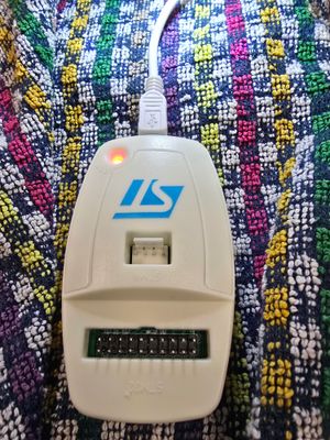

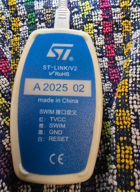

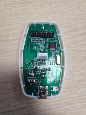

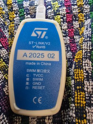

I bought this  ST-LINK V2 on Amazon ( see pictures) . I don't think its' a genuine STM device. STM32CubeIDE and STM32CubeProgrammer recognize it but No STM32 target is found ( STM32L051K8U6)
I notice that my ST-Link V2 does not provide clock signal on pin 9 (SWCLK)
I'm using VT ref pin, SWDIO pin, SWDCLK pin, GND pin and RST pin.
Amazon is not an ST Distributor - so that alone almost certainly means it's a fake.

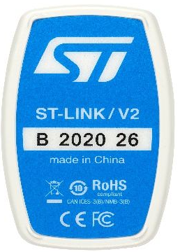

@Fabrice44
According the pictures you shared especially this one:
that's not a genuine ST-LINK but it's a copy of it.
The genuine one has this look and feel:
