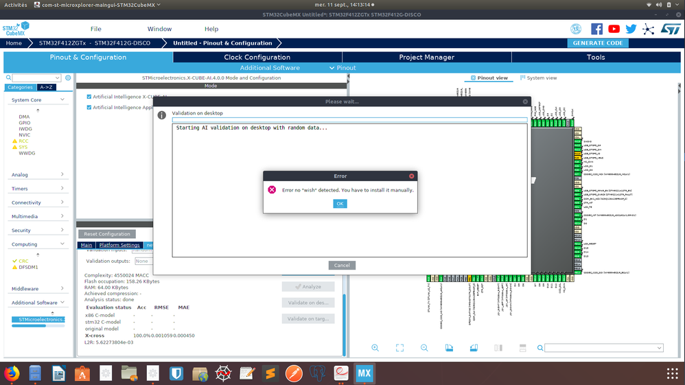

Error no "wish" detected with X-CUBE-AI
klim
0690X00000AR3FNQA1.pngI'm trying to create the KWS model found on
https://github.com/Shahnawax/KWS-ANN-KERAS
and I'm trying to implement it on an STM32F412G-DISCO MCU.
I've followed the lines of
https://www.st.com/content/ccc/resource/technical/document/user_manual/group1/69/bb/ec/5d/78/16/43/ce/DM00570145/files/DM00570145.pdf/jcr:content/translations/en.DM00570145.pdf
by installing STM32CubeMX and then the X-Cube-AI component.
When I load my Keras model as an h5 file and analyze it it works fine, but when I want to try to "validate on desktop" I've got the error seen on the screenshot
Error no "wish" detected. You have to install it manually
I'd like to but I don't know where to find it. I'm running on Ubuntu 18.04 LTS.

please install tk using the following command:
sudo apt-get install tk

That seems to work.
Thanks
