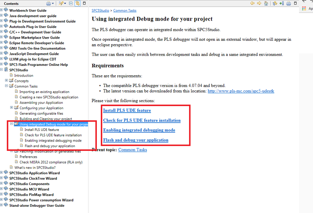

Hello Matthew ,
Did you install PLS UDE ?
https://pls-mc.com/login-a-html?User=SPC5UDESTKUser
there is 2 ways to debug
  • Use the eclipse debugger based PLS UDE(plugins)
  • Use External tool PLS
Anyway , PLS UDE should installed first.
Have you tried the help sections ?
Best regards
Erwan

Posted on November 20, 2017 at 10:34
Hello Matthew ,
For your information , we do not develop PLS Eclipse Integration plugins
The last version will still be in this following directory :
c:\Program Files (x86)\pls\UDE Starterkit 4.8\UDEEclipse4Integration.zip
Anyway , in some cases there is an issue linked to the PLS Workspace association in windows
cf ,
https://community.st.com/community/automotive-mcus-community/spc5-automotive-mcus/blog/2017/11/20/tip-pls-default-program-issue
   Best regards
