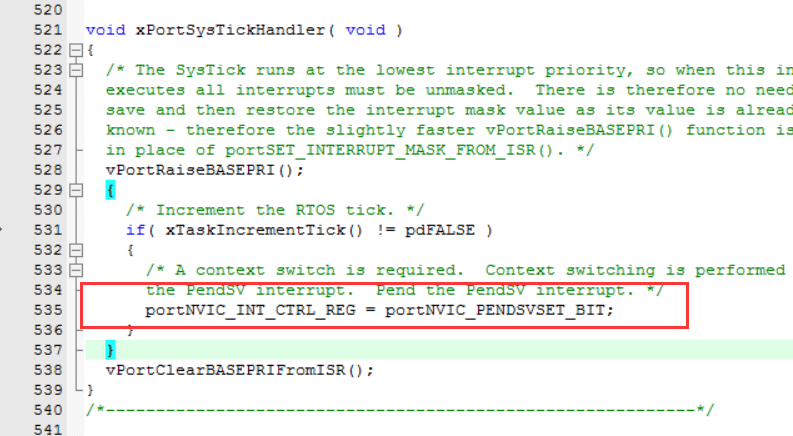

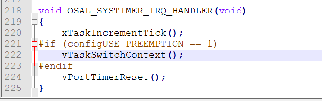

If the kernel need to switch task in the SystemTick(PIT0)ISR,  this should be to trigger a SystemCall.
STM32 PORT:
the vTaskSwitchContext function only made some judgments, to modify pxCurrentTCB, and did not do the task switch.

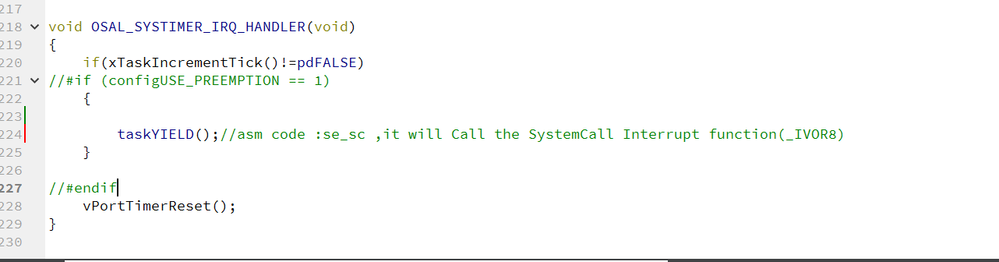

I modified the code:
But I found that there is no task will not switch

Hello Guo ,
I am submitting an ER on FreeRTOS components part.
Thank you for sharing your findings ;)
