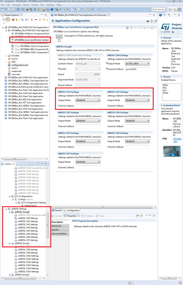

I want to generate PWM with channel 1,2. I saw the PWM example but it is for channel zero, what are the changes required for channel 1 and channel 2.

Hello Soni ,
If you use RLA drivers ,  you can change the configuration (cf screenshot)
Do not forget to generate after saving your configuration.xml

pratibha soni
Posted on November 23, 2017 at 11:32
Hi Erwan,
thanks but want more info because I already set the channel configuration but in this channel callback also required? in  for channel 1 and 2 ??whether I am using 0,1,2 or in ch 0 default callback is there.
Posted on November 23, 2017 at 15:55
Hi Soni ,
No callback is required
         BR
                  Erwan
Posted on November 23, 2017 at 17:18
Only changes in configuration.xml or nothing else... Even not in code too??
pratibha soni
Posted on November 24, 2017 at 05:44
will be like this?
for channel 0
pwm_lld_enable_channel(&PWMD5, 0, PWM_PERCENTAGE_TO_WIDTH(&PWMD5, 5000), 0);
for channel 1
pwm_lld_enable_channel(&PWMD5, 1, PWM_PERCENTAGE_TO_WIDTH(&PWMD5, 5000), 0);
for channel 2
pwm_lld_enable_channel(&PWMD5, 2, PWM_PERCENTAGE_TO_WIDTH(&PWMD5, 5000), 0);
