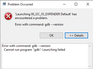

We are currently using the AEKS MCU-SPC5 LNKU Kit to debug our custom board. However, we are encountering a "launching error" when attempting to connect to the board via SPC5 Studio.
 For your reference, we have attached the error image below.
We would like to understand whether any specific debug configuration is required within SPC5 Studio for successful debugging.

Max VIZZINI
Yes, the programmer you are using is for PLS UDE debugger.
For you own custom board you need to contact PLS support and agree with them.
Some license information is required to properly program the FTDI chip otherwise the software will not allow the connection.
Sorry but we cannot help you further with this.
