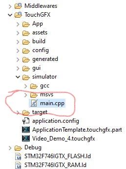

0693W00000BadUzQAJ.jpgAnd in STM32Cube IDE main.cpp file show hide, that screen short also attached below

At 2 main.cpp is only for PC Simulator and in CUBE is excluded OK
