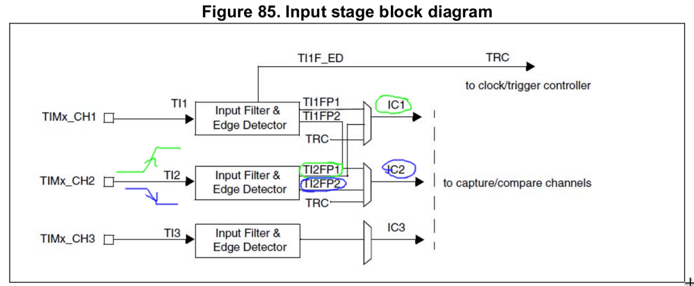

If you want to get the precise time of an edge of a signal, you went the wrong way. If you enable an external interrupt on a port and in the execution of the interrupt you "manually" read the timer you get errors due to interrupt servicing times and others...
You should activate an input capture interrupt for the timer you use and input your signal on the timer input pins. This way you will have errors <= timer period.
You can even use 2 channels, each on differernt edge (rising/falling), so this way you know exactly what edge you have in the interrupt, without needing to test the pin.

So, I don't know your setup, but you say you want to use TIM2_CH2 input pin. You could setup TIM2 the following way:
(The image above is from RM0016)
Set inputs for channels 1 & 2:
TIM2_CCMR1 = 0x22 (N=4 samples filter, input for CH1=TI2FP1)
TIM2_CCMR2 = 0x21 (N=4 samples filter, input for CH2=TI2FP2)
now you need to set the active edge and enable capture:
TIM2_CCER1 = 0x31 (rising edge for CH1 and falling edge for CH2).
You still need to enable the capture interrupts and maybe also the update interrupt to keep track of time.
Every edge will capture TIM2 value, and then you have enough time to read the captured value. Simple math, by subtracting the time between 2 edges will give you the captured signal.
Good luck!
