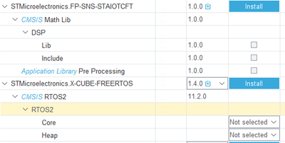

So I have a board which I'm correctly using with threadX and TouchGFX.
I want to implement a function that calculates the FFT of a signal, but I'm having a hard time finding the CMSIS-DSP libraries.
I need to include the classic math library for ARM
#include "arm_math.h"
#include "arm_const_structs.h"

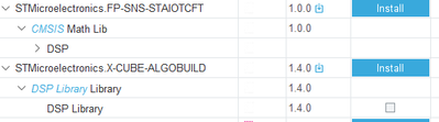

But in cubeMX I'm finding various DSP libraries
what should I use?
nico23
Senior III
Ok, so the issue has been fixed following this https://community.st.com/t5/stm32-mcus-embedded-software/quot-first-defined-here-quot-error-with-cmsis-dsp-1-15/td-p/601583

Andrew Neil
Does this help: How to integrate CMSIS-DSP libraries on a STM32 project ?
Also: Configuring DSP libraries on STM32CubeIDE ?
AHai @Andrew Neil
This helped a lot, thanks! The only thing that seems not to be explained is why I'm seeing a series of error "multiple definition of" "first defined here"
<my_project>/Drivers/CMSIS/DSP/Source/FilteringFunctions/arm_biquad_cascade_df1_q15.c:318: multiple definition of `arm_biquad_cascade_df1_q15'; ./Drivers/DSP/Source/FilteringFunctions/FilteringFunctions.o:<my_project>/Drivers/CMSIS/DSP/Source/FilteringFunctions/arm_biquad_cascade_df1_q15.c:318: first defined here
 Which one was I supposed to keep?
