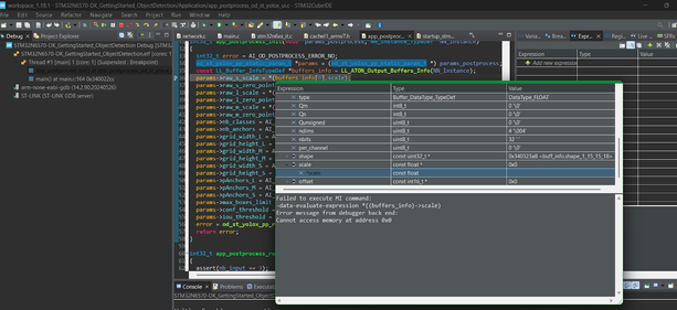

At my workplace, we have purchased two STM32N6570-DK boards to implement our computer vision models. We are currently trying to implement the "st_yolo_x_nano 480x480x3" model from the ModelZoo.
We followed these two links, strictly respecting the versions indicated for both STM32CubeIDE and STEdge:
The Issue: Every time I attempt to debug, the same thing happens: the program enters a HardFault_Handler(). This occurs due to an invalid/null pointer error returned by the function LL_ATON_Output_Buffers_Info() in buffers_info[0].scale.
The error happens specifically when it reaches line 36 of the code. According to the debugger, it cannot access memory at address 0x0.
Technical Details:
  • Configuration: The app_Config.h file being used is the one provided in the ModelZoo.

@Monk Eastman,
On your image we see a DataType_Float; so, it is normal that scale and offset are NULL.
I think you need to use POSTPROCESS_OD_ST_YOLOX_UF (float) and not POSTPROCESS_OD_ST_YOLOX_UI (int)
I would suggest that you use the model zoo script deployment operation mode to deploy this model. It does a generate with options to have int8 output and manage automatically the app_config.h config. (Using the ui in this case of course).
Also, we fix the bug I mentioned in my last message. It was a postprocessing bug. So, if you encounter what I described, please wait for the model zoo script update 4.0, planned for end of January.
